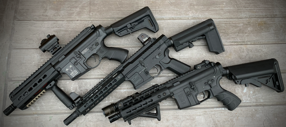

Speedbird_666 Posted September 7, 2021 Posted September 7, 2021 4 hours ago, Steveocee said: Will be equally as accurate however have you thought about just adapting an M4 you already have and like with something like this? https://www.badas.design/shop Did someone mention dropstocks?....? As a paintball goggle wearer myself, half my guns now sport drop-stock adapters that I designed and 3D printed. I know some people hate 'em, but they are very practical. The SSG1 is pretty expensive for what you get and it's very much intended for Speedsoft/CQB play. That's not to say it won't perform just fine at woodland distances, but a DMR platform it is not.
