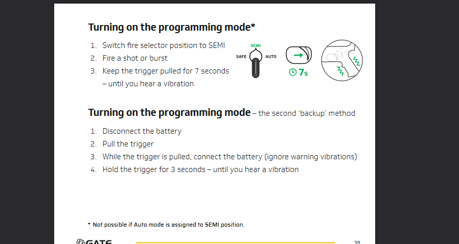

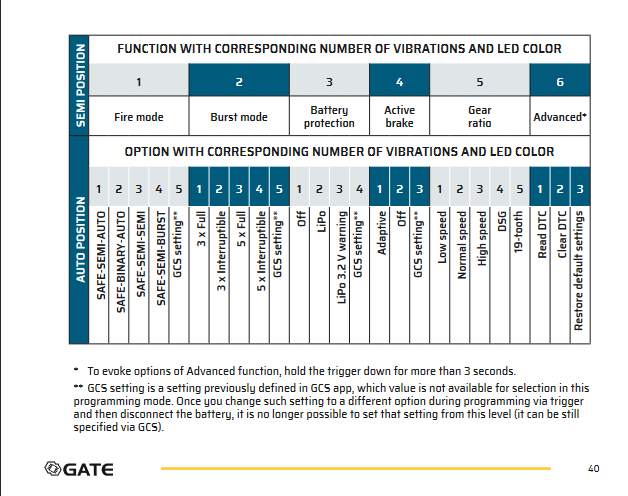

Misery Posted August 15, 2021 Posted August 15, 2021 On 13/08/2021 at 20:29, Niels Henriksen, DK said: Yep. Sure, programming is nice, but I really just want something that doesn't take up space in the tube and allows me to spam semi. No fancy active braking, precocking or whatever the usb link doesnt stay connected bud you disconect it after you haved it its only the blue link that stays connected to your riff as beenb said its definatly worth it as it gives u the option to be able to check the selector properly you can program through the selector have found this for you
