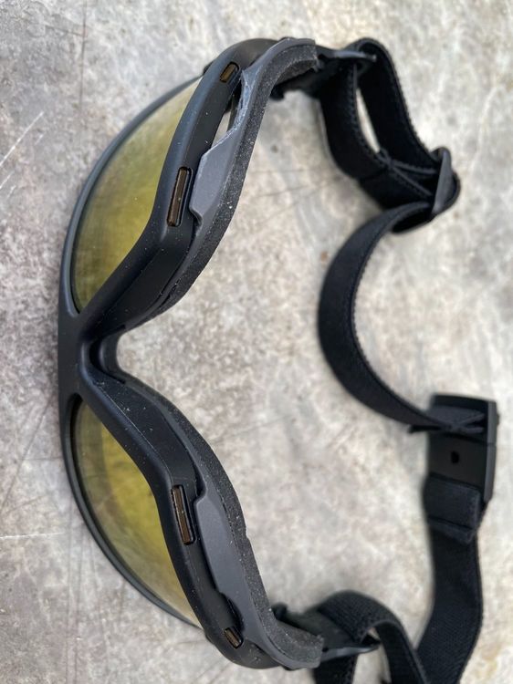

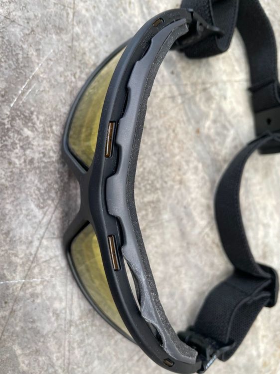

Low tech solution here - dual pane glasses from Pyramex I-force slim.
Using them with FogStop they were perfect EXCEPT when you pelt it to the 4th floor of C wing and then stand in the corridor defending “Dave” (UCAP VENDATTA players will know!) when I started to fog up in the left lens only (my shooting eye and the only one I wear a contact lens in…weird!)
I then took a dremel to the outer gasket frame part (having removed it from the main glasses body) and opened up the scalloped areas to allow more air flow. Still can’t fit a BB through the gap and none should be coming directly UP or DOWN anyway!
Result is now that I do get a tiny strip of fog at the top of the lens, probably because the baseball cap slows the airflow but the main part of the lens stays clear.
Pics below show one side modified vs the standard vent size
Yup, I did exactly the same. Used with either Cat Crap, or (better for me) Revision wipes, iForces nearly work.  I'm on my 2nd set of inner lenses, just PETG plastic and double sided foam tape.  But on a humid day, standing still after running, and wearing lower face mesh, a fan is still the difference between victory and victimhood.
