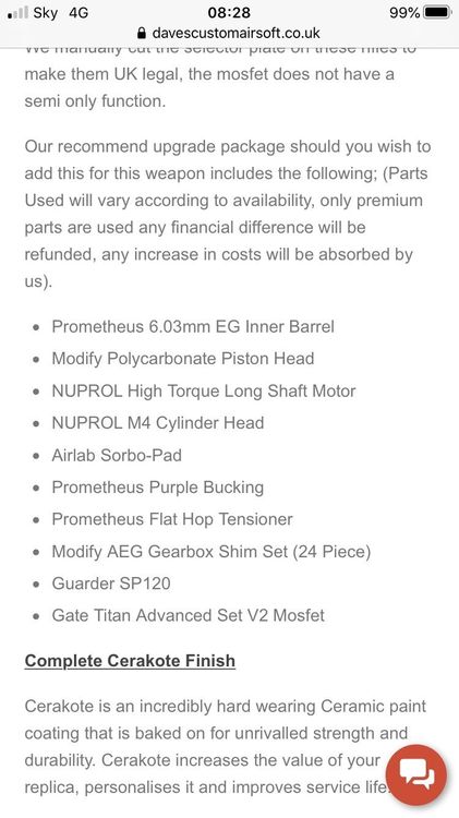

i bought a dave custom modded cm.098a e off here and im loving it had it to 2 skirmishs so far and its like a lazer
this is the list of parts fitted

to be fair the standard hop unit isnt actualy that bad as mine still has the stock hop unit but upgraded rubber and nub and a uprated barrel and it was performing amazingly last weekend,i do want to upgrade at somepoiint but for now i dont feel the need to
