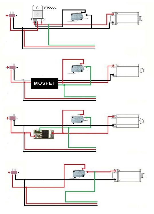

Everything appears to be wired up correctly with the signal wire and positive going to the microswitch, the negative going directly to negative motor terminal.
LEDs blink green on battery connection and gun fires when trigger is pulled. However, intermittently it will stop firing with the LED's flashing red/green. According to the help card, this is the trigger wire being connected to the negative motor wire. Obviously it's not.

This is probably largely due to it also being wired to run a box mag, per the second diagram attached. Running this setup didn't seem to work. I got no additional signal from the signal wire and my electronics is weak so I didn't understand why.
Ultimately, there was a lot of rebuilding/rewiring anyway and during the course of this I changed the signal wire setup to dual wire on the switch rather than single + power. This was largely so I could swap out mosfet at a later date if I wanted. Unfortunately the X-ASR is single signal wire only, so I switched to an old Gate one from the parts box.

Incidentally, is the wiring in the 2nd picture actually possible? I'm assuming the box mag also has its own mosfet within it and was trying to get my head round 2 mosfets being driven by the same signal wire.
Not sure why the box mag would have a mosfet in it?
I'm also confused as to how you can be getting low voltage, high resistance AND high current. I'd try checking what current the motor is actually pulling though as it may be higher than you're expecting.
In theory, the box mag is wired direct to the battery and also has a signal wire. It's got a manual feed button on the side (mostly for priming) but should fire when the trigger is pulled (per the diagram). I assumed this indicated a mosfet, however see previous comments about this not being my area.
I also have no idea on the other info, I'm just going based on what the light flash diagnostics on the NanoHard are suggesting. I don't have any way to actually check the current that's being pulled. However, given the box mag wiring is about 20/22AWG I feel like it's not going to be that much.
