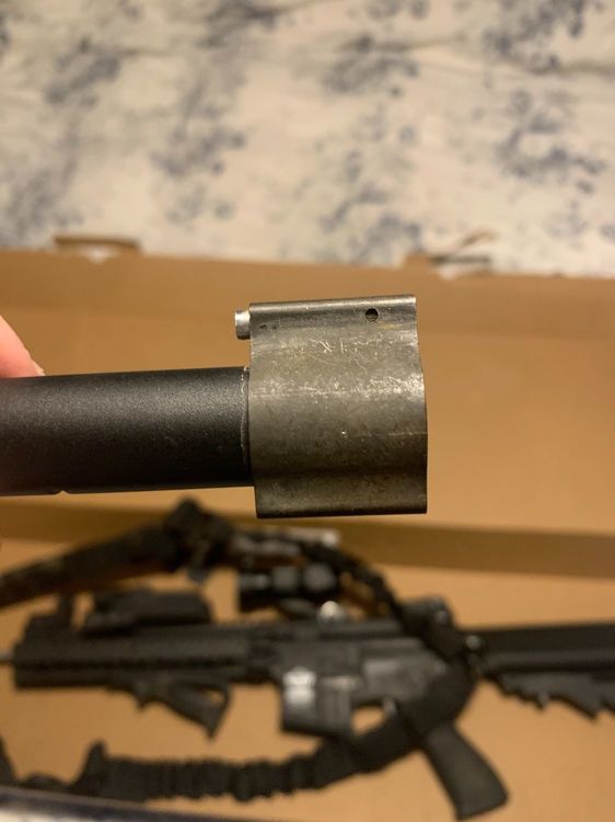

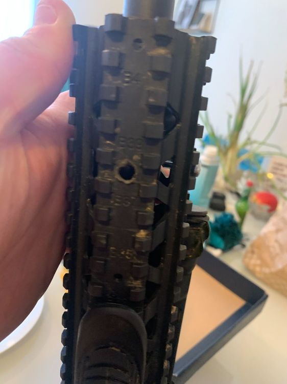

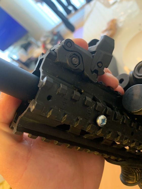

Chubluke Posted March 17, 2021 Posted March 17, 2021 Hi everyone , I’ve got a G&g cm16 r8L as a starter gun. I was giving it a check over before my first game after lockdown and noticed the outer barrel which the flash hider screws onto just pulled out. the screw to hold it in place was missing, see image 1, so I just whacked two self tappers on either side to hold it in place. Image 2 i think it is pointing slightly to the left now, but I don’t have anywhere to test fire it - from people’s experience can this normally be fixed by adjusting the sites? I don’t really want to replace any parts as I’m planning to buy a new aeg in the next couple months

Chubluke Posted March 17, 2021 Author Posted March 17, 2021 The big hole is on the underside of the rail, up towards the end of it, where I believe the grub screw was before but has fallen out as the hole is clearly damaged. As this is my first aeg I don’t know if the outer barrel is meant to be held in by a grub screw there but it does line up exactly with where the outer barrel joins with the inner and I can’t push it in any further, so it would make sense for it to be there. the two self tappers I’ve put in the sides are because the hole on the bottom is totally rounded out and I don’t have anything that will fit in that hole now. I’m aware it’s not ideal but I’m hoping I can counter it with re-adjusting the sites.
Supporters Lozart Posted March 17, 2021 Supporters Posted March 17, 2021 8 minutes ago, Chubluke said: The big hole is on the underside of the rail, up towards the end of it, where I believe the grub screw was before but has fallen out as the hole is clearly damaged. As this is my first aeg I don’t know if the outer barrel is meant to be held in by a grub screw there but it does line up exactly with where the outer barrel joins with the inner and I can’t push it in any further, so it would make sense for it to be there. the two self tappers I’ve put in the sides are because the hole on the bottom is totally rounded out and I don’t have anything that will fit in that hole now. I’m aware it’s not ideal but I’m hoping I can counter it with re-adjusting the sites. The handguard is supposed to be "free floating" so there's not supposed to be anything bracing the barrel at the business end.
Speedbird_666 Posted March 17, 2021 Posted March 17, 2021 Yeh, the barrel is not supposed to touch the rail at all. Bin off those self tapping screws. There is no screw between the rail and the barrel on the stock gun.

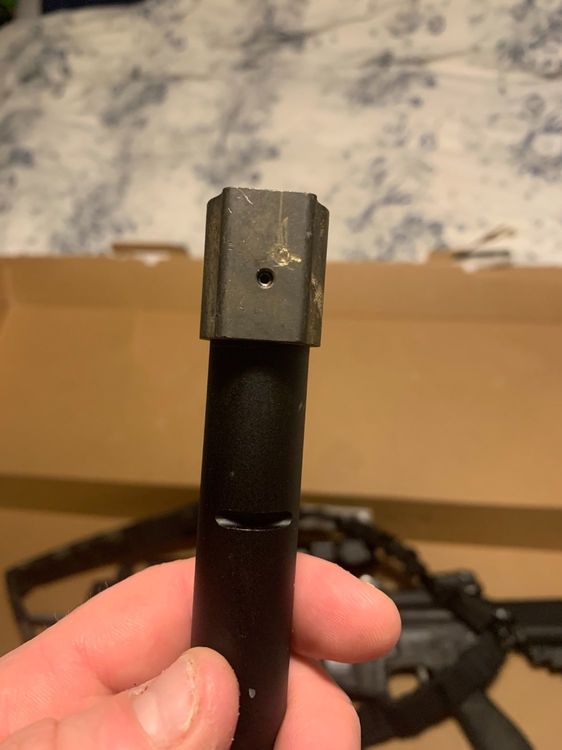

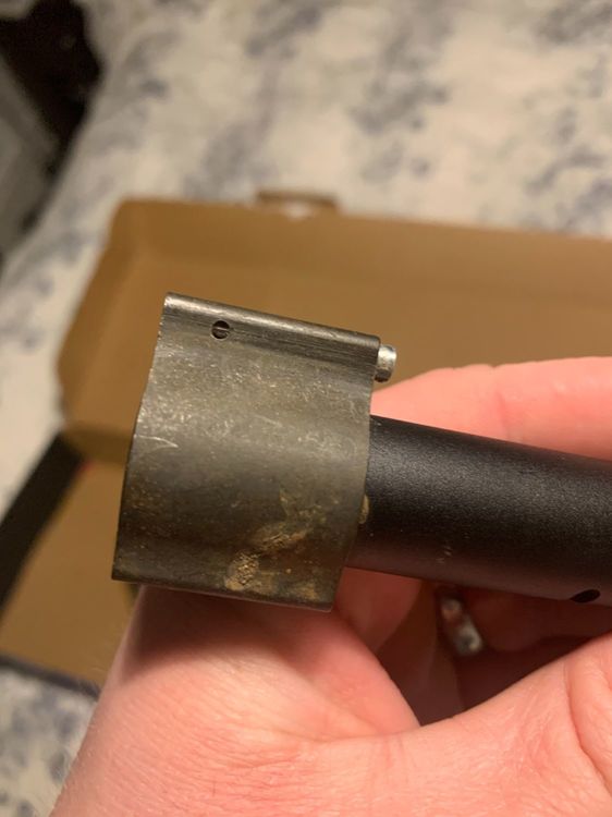

Speedbird_666 Posted March 17, 2021 Posted March 17, 2021 46 minutes ago, Chubluke said: Ok I’ll take them off. But shouldn’t there be something to stop me being able to pull the outer barrel off that easily? I can just take it right out with 0 resistance, was worried it would fall out whilst playing There are grub screws at both the receiver end of the out barrel, and at the front where the two peices of the outer barrel meet, make sure they are tigthened down, but don't go mad, you'll strip them out: It's literally those four screws that hold the three parts (Receiver stub, thin mid piece and fatter decorative end piece) together. A bit of a weak spot on these guns. I do know of people that have literally epoxied the pieces together. Not that I would normally recommend such a course of action, but if you are just shoring up a gun you intend to bin off later, it might tide you over if there is a problem with the grub screws. Do so at your own risk.
Chubluke Posted March 17, 2021 Author Posted March 17, 2021 Ok I’ll try that - so it’s the screws you’ve highlighted in yellow yeah? The only grub screw I can see here is the one on the bottom which I can’t access once the barrel is pushed into the handrail?

Speedbird_666 Posted March 18, 2021 Posted March 18, 2021 That single grub screw holds the fake gas block on. Loosen that screw and wiggle the gas block off the barrel. Once removed, you’ll see the other two screws that I highlighted.
