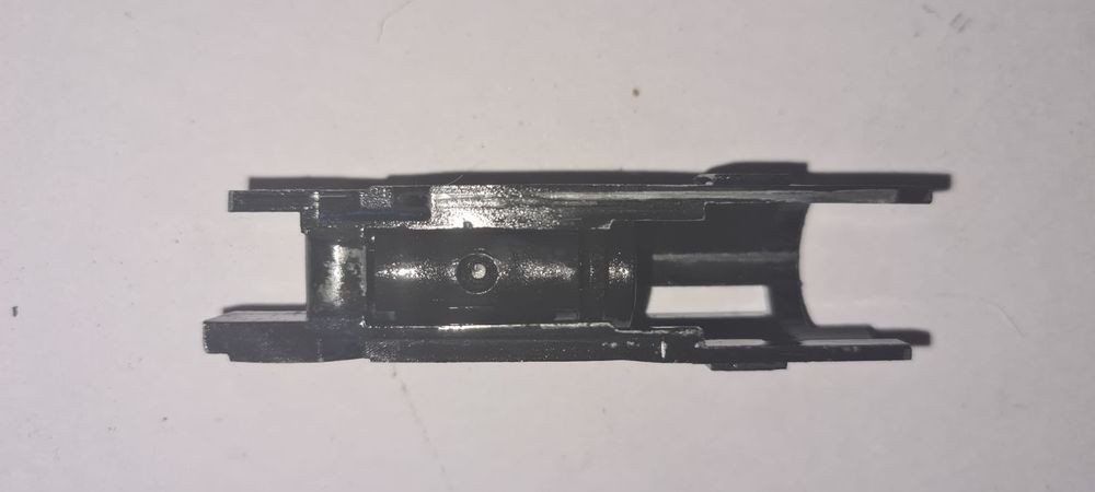

I had a similar issue recently and it was the bolt that held the shaft inside of the bbu had loosened. It’s relatively easy to get to, you’ll need the slide off.
Remove the guide rod and barrel assembly. Loosen off the bolt at the rear of the slide and top bolt if there is one. The Bbu will either drop out of the slide at this point or you’ll have to gently push at the nozzle to get it out.
Dont lose your nozzle spring when the BBU drops out!
Pull and lift the nozzle out of the BBU housing and you should be able to have a gander at the piston/o ring assembly. Check the seal when reassembling and give it some silicone
While you’ve got the nozzle out, it’s worth testing that the floor valve is moving freely. You can gently push the valve through the nozzle with a small Allen key or similar. It should spring back when pushed and should spring an Allen key across a desk...

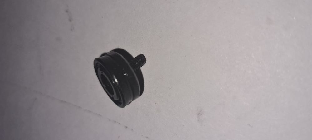

having delved more into it im suspecting the previous owner has worked on this found a broken mag release under the packaging,but also when looking at the piston assembly there seems to be a snapped screw going through the piston
is it me  or does that look to be missing an oring seal?
ok so looking at it i may just be better cutting my losses and ordering a new bbu to save trying to drill out that screw and rethread etc .so im assuming it would be the bbu and rocket valve thatid be replacing? minus  nozzle and piston head/piston head rubber they seem ok@Adolf Hamster @Alimcd

I’d go down the repair route first. Hi-capa parts are a minefield and you can easily end up spending more on the replacement parts than the entire bloody pistol. (See my Novristch SSP1 thread as a prime example!) If you end up with a new BBU (25-30) and it needs a different nozzle due to tolerances (10-20) and the new nozzle needs a stiffer nozzle spring (5)
It does look like there’s a ridge for an o ring. If you can get a seal there, I suspect the low FPS issue will be solved.

i can get oem jw3 bbu from bespoke speaking with them just now about it
yeah wouldnt the missing screw head in the pic above that holds the rocket valve i think its called be blowing the seal aswell causing the issue?
yeah theres a fine ridge on it id reckon i could find a seal to fit that online
looking at 11.99 for the bbu and 1.99 for the rocket valve from bespoke

The rocket valve assembly is all in the loading nozzle. As long as it closes when pressed in, it’s unlikely to be the cause of the issue.
Might be worth double checking with bespoke that the BBU assembly comes complete with the piston head. I’d be surprised if it didn’t but lots of daft things happen in Airsoft
EDIT - Just followed your link for the BBU. It doesn’t look like it comes with the piston head. I’d ask them for a complete BBU + piston head.
yeah he said in email they do the complete unit will get one ordered tonight i did send him that pic with the missing screw head so he knows exactly what parts im needing  rather than my crap describing haha
nope that is the seal. the concept is the shape of it mushrooms out a bit when the gas pressure hits it sealing it up against the walls, although they do seem to be somewhat sensitive and easily worn.
it should have a very light fit to the nozzle going the whole way down, if the nozzle is bulged it might seem a nice fit at the end but not once it's all the way in.
you can get aftermarket styles that look almost like a miniature aeg piston head with a seperate o-ring.
maybe a grub screw or a pin? can't really tell from the pic. in theory anything behind the piston head *shouldn't* matter for air seal so unless it's loose/wobbling then might not be an issue.
as @Alimcd sayd if you're replacing the bbu might as well change the nozzle as well, just in case it's scored/bulged/had the rocket valve spring snipped.
right having replaced the bbu piston head rubber and full nozzle assembly also fitted the autobot rubber im now into the 100fps consistently im attributing that to the hop rubber rather than the bbu itself,ok sothat rules out the compression side of things,so light striking you say how do i solve that issue? @Adolf Hamster @Alimcd
