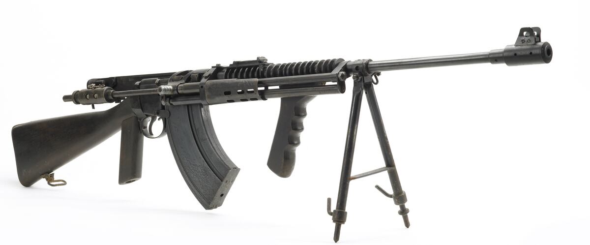

Spartan09 Posted January 26, 2021 Posted January 26, 2021 starting a new thread, after clogging the "what have you built" thread with some chatter between myself and @Adolf Hamster. as the title suggests, this thread is about my plans to make a GBB Charlton LMG. any advice on modding/ remaking GBB guns would be much appreciated. updates to this thread will likely be in the distant future, as due to lockdown boredom spending, i dont have a lot of funds spare at the moment to dedicate to the project so far i have identified some real-steel lee-enfield stocks, trigger guards and sights that i could buy to add to the gun.
BigStew Posted January 26, 2021 Posted January 26, 2021 You'll want something that is as drop in as possible that the Frame can be built around. A small SMG or full auto pistol rather than M4/ak unless you got the cad skills to design a new housing. Actually a kjw Ruger 10/22 might be a shout as they can be modded to full auto and higher capacity mags have just be released.
Supporters Adolf Hamster Posted January 26, 2021 Supporters Posted January 26, 2021 y'know looking at that picture again, the gas tube looks a bit thin for my original plan of having the reservoire in there. so maybe we're back to square 1 in terms of thinking about something like an m14 action.

Supporters Adolf Hamster Posted January 26, 2021 Supporters Posted January 26, 2021 hmm this is an interesting challenge, damnit you've got me staring at pictures on forgotten weapons trying to figure out how to do it. i'm trying to think of ways to get gas routed into the external gas tube as that means building the cycling mechanism as-is. problem is i can't see a way of doing it that doesn't involve a very long travel time (which is gonna murder gas effeciency)
Spartan09 Posted January 26, 2021 Author Posted January 26, 2021 24 minutes ago, Adolf Hamster said: hmm this is an interesting challenge, damnit you've got me staring at pictures on forgotten weapons trying to figure out how to do it. i'm trying to think of ways to get gas routed into the external gas tube as that means building the cycling mechanism as-is. problem is i can't see a way of doing it that doesn't involve a very long travel time (which is gonna murder gas effeciency) thinking on the project a bit more, im wondering wether it would be better to try and run it as an HPA gun, with a line in through the stock or grip, and trying to run hi-cap AEG mags. surely i can have the gas routed through the bolt as with an AK, and then just make the gas tube as a mock piece, but build the recoil and return springs inside it
Supporters Adolf Hamster Posted January 26, 2021 Supporters Posted January 26, 2021 15 minutes ago, Spartan09 said: thinking on the project a bit more, im wondering wether it would be better to try and run it as an HPA gun, with a line in through the stock or grip, and trying to run hi-cap AEG mags. surely i can have the gas routed through the bolt as with an AK, and then just make the gas tube as a mock piece, but build the recoil and return springs inside it i was thinking about something like that, afaik that's how the m14 does it (with a reversed "lockup" so it's the bolt actuating rather than the other way round) thing is it'd be effectively short stroked as with a fixed bolt protrusion like that it's gonna clip the reciever before the bolt has gone all the way back. maybe a livable option though, you wouldn't notice when shooting and it would only show when racking it.
Spartan09 Posted January 27, 2021 Author Posted January 27, 2021 11 minutes ago, Adolf Hamster said: i was thinking about something like that, afaik that's how the m14 does it (with a reversed "lockup" so it's the bolt actuating rather than the other way round) thing is it'd be effectively short stroked as with a fixed bolt protrusion like that it's gonna clip the reciever before the bolt has gone all the way back. maybe a livable option though, you wouldn't notice when shooting and it would only show when racking it. should be a fair compromise. also, i decided to email Ian at forgotton weapons to see if he has, or knows anyone else that has more detailed measurements of the real steel that could help me start making some basic drawings and allow me to be able to compare those measurements to GBB AKs and M14s to work out wether its feasible to modify a base gun, or better to just try and make a gun from sratch
