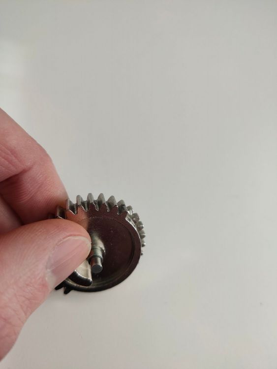

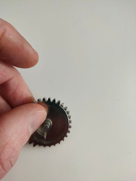

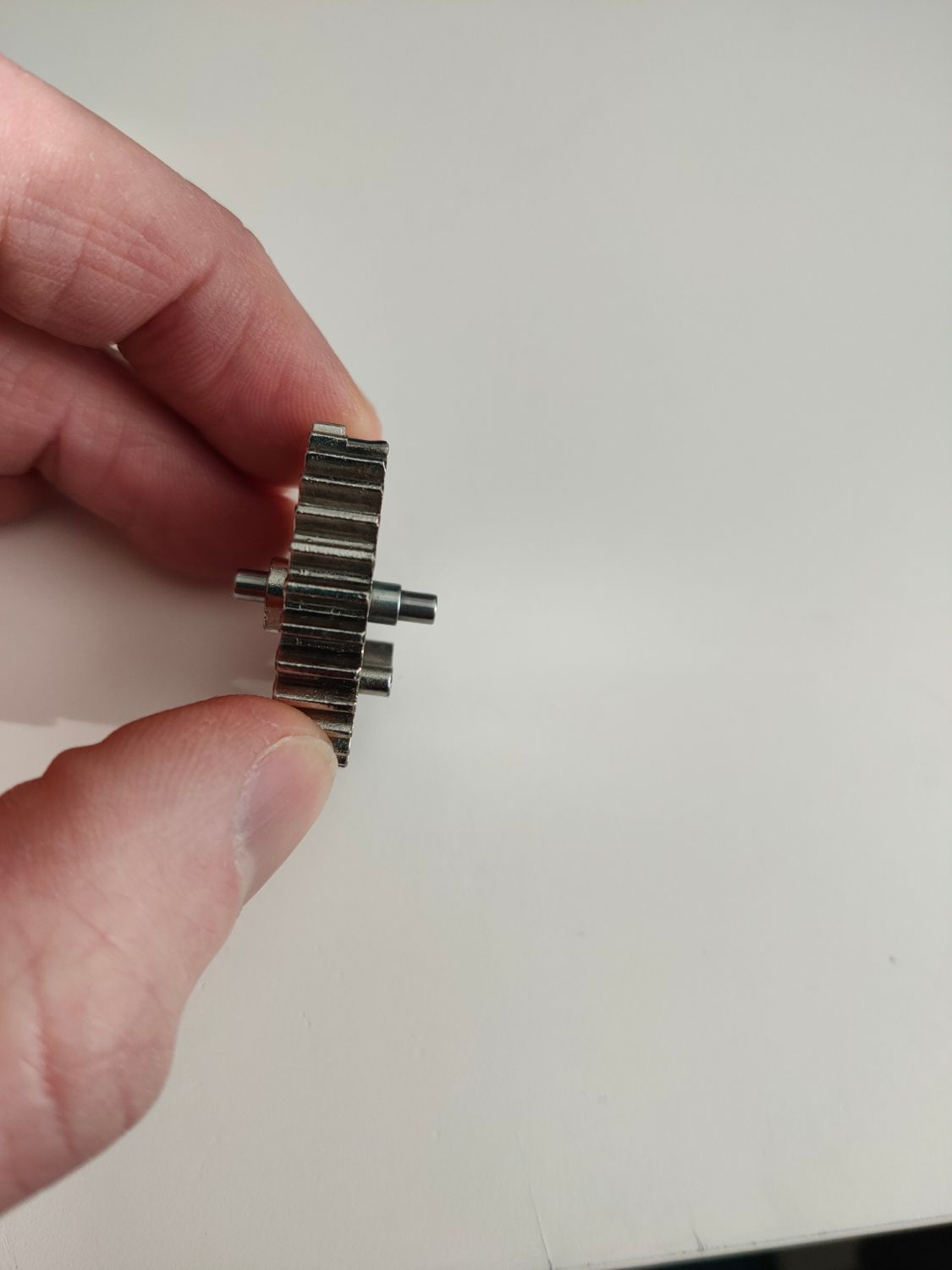

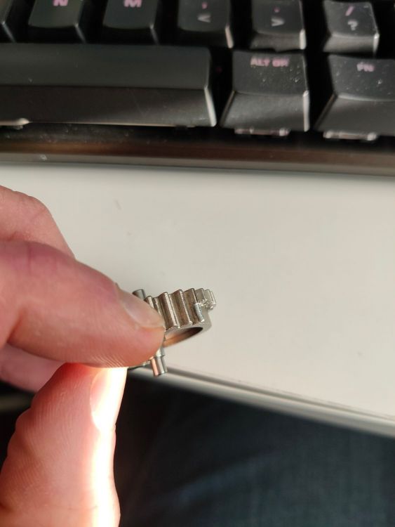

Anyway, I wasn't planning on replacing to gears due to keeping the power modest, but when I took it apart yesterday evening I noticed what looks like a small amount of wear on the sector gears release tooth (pics attached). Is this anything the worry about or is it normal? Should I purchase some upgrades gears while it's open, I would get Lonex gears if I did and can be had for around £50.
So would you bother replacing it? It seems to mesh well with the Prometheus piston, but I don't want to be going back inside after a could thousand rounds because the release tooth has s**t itself :) The gun has to now been running stock for about 5K rounds on 7.4v 1450mah 30C lipo's.

depends on the round count i'd say, if you've sent a lot of plastic downrange then that wear might not be so bad, if the gun hasn't seen that much use then maybe worth changing.
that's the tooth that will get all the abrasive wear, but not seen that much ground away before, but granted i've not worked on anything with a really high round count that didn't have something more serious wrong with it.
Yeah for the sake of possible frustration later down the line, I've gone and ordered a set of Lonex gears. Could of got Nuprol Marui gears for a bit less but I couldn't find info on who OEM them and whether they are decent or not, so I went with Lonex.
5k rounds is not much to be frank and Marui gears should not need replacing that soon. Granted they ain’t made froM forged steel but still that amount of wear is a tad surprising. How’s the pinion gear on the motor? The fact that you’ve ordered Lonex gears that’s fine. When you plonk it all back together make sure the shinning is done right. The motor to bevel gear is important as well as the other shimming. Coz you’re installing lonex gears you may need to adjust the motor height to compensate.

I was surprised as well when I opened it and noticed. Their is no noticeable wear anywhere on any of the other gears and the shimming/motor height was pretty decent. I will be giving it a full reshim following the pinion the bevel method when I put it back together.
The piston looks good as well with no wear, just the release tooth on the sector gear has worn down and now mimics the contour of the last tooth on the piston as obviously that metal must be stronger than the metal of the sector. Maybe I have just been unlucky ?‍♂️
It would probably carry on like a champ as it still seems to mesh fine with the Prometheus piston I will be fitting, but I will replace them for my piece of mind.

That gear wear is completely normal on a stock NGRS, they ‘bed/work harden’ themselves into wear pattern and if you leave it stock it will run for years without fault.
