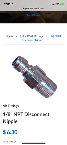

Back to your original question on fittings, ‘standard’ air filling fittings are the male/female quick disconnect and 1/8” NPT screw fittings. A male nipple on the cylinder or equipment and a female from the fill station:
