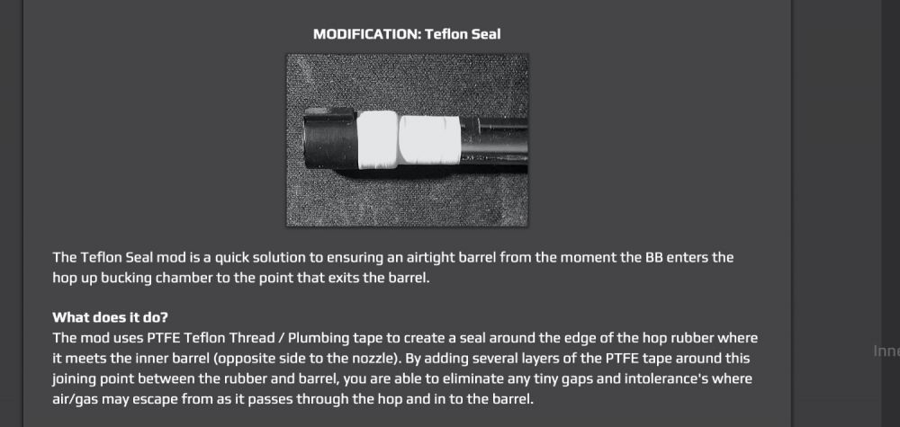

I dislike Crazy Jets as both of mine don't fit properly into the hop units as the outer diameter isn't large enough, meaning I would need to wrap PTFE tape around the outside to make it fit. This leads to the alignment being ever so wrong (literally < 1mm off) and so the BBs clip the suppressor. I imagine this would be amplified in a DMR kit. They're more expensive, but I'm a big fan of Edgi and PDI barrels. Nineball (Laylax) are also good if you're on a budget, but with pistol barrels the difference is usually tiny so I'd say just go big or go home. Stock TM barrels are pretty good.
I've always wondered why PTFE tape was needed for a Crazy Jet barrel as it's bonkers... I've never found an explanation for it until now....!
Also, having to apply teflon tape is just bollocks! You shouldn't have to do that! Imagine what Luke would say :D:D

No, because I'm not doing it for airseal. I'm doing it part of the way down the barrel where it exits the hop unit to make it fit snug. Otherwise it doesn't quite fit and rattles around and doesn't line up properly. This has only happened to me on Crazy Jets and has happened with both I have (both on the mk23 and VSR).

Have you tried shoving an 0 ring over the barrel to help centre it? Also which version of the CJ barrel do you have? There's a newer version according to Skirmshop which doesn't need a modification of the inner hop to accommodate the barrel...
