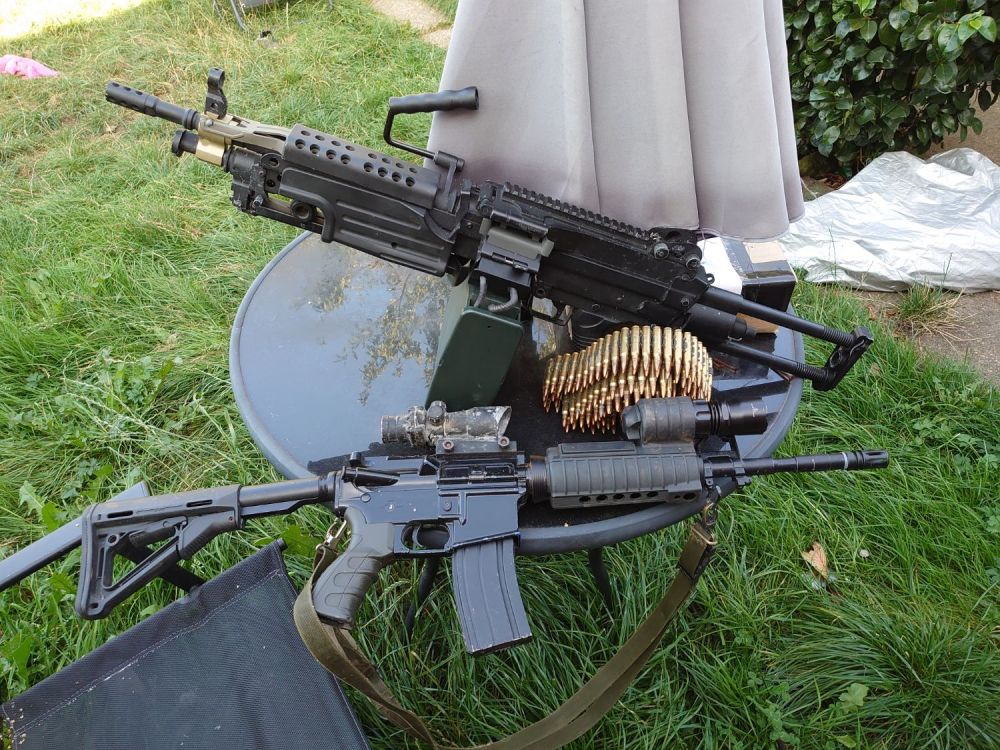

Thought I’d test this, having picked up an A&K MK46 over lockdown. 500rds later, I’d better get the hoover out in the workshop!
My box mag keeps up with a 2600Mah 25c 11.1v Lipo in the context of a high torque build, (M100, Shs High Torque, 18:1) and has a reliable 23-24RPS output although I’m not sure you’d want an LMG delivering a higher ROF?! It'd start to get expensive if you were laying down a bag of 0.28's per minute!
Ignoring the battery, The hop chamber  in the MK46 is a bit shit and the new V2 Airsoft Pro unit is a worthwhile replacement for consistency. With a bit of feedlip shaving you can get a Maple Leaf 50 and nub in there and have an LMG that offers the same range as all the other AEGs on the field (as opposed to sometimes!)
