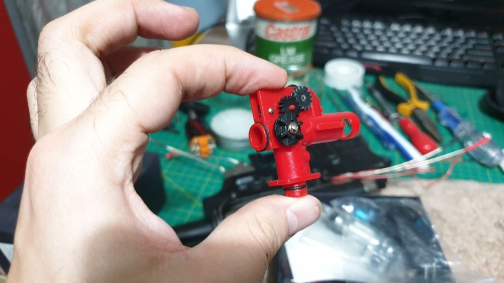

Took the ML Macaron and omega nub out and put in the flat hop setup I was using before - this got it firing again, though with very low FPS about 150 (previously had been doing 330 on the dot for CQB).
I went back inside the GB a few times to diagnose air seal however it proved to be a hop mod which I had made with the intention of improving air seal that was actually wrecking the setup. I had put a tiny O-ring (about 0.5mm thick and about 8mm wide) around the lip of the hop unit which goes inside the GB shell; that tiniest 0.5mm was totally throwing the air seal off - I think that slight gap between the hop and GB shell meant that the nozzle was not sealing correctly with the hop rubber lips when it was all the way forward in the firing position. Either way, took that O-ring off and the power zapped straight back up into the 300s, firing every time the trigger was pulled.
The thing that I find annoying about this was I wasn't able to get that perfect air seal I was looking for based on spring performance. A couple of months ago I rated all my springs with my MP5 QD build. I ended up using a spring marked 385 on the MP5 which actually has a slightly shorter barrel than the MK18. That spring is giving me 355 on the MK18 - I assume that to mean the air seal on the MP5 is just better ?
why did you install this ???
I've built up some tape between front of gearbox & hop which is effectively the same thing
or seen posts saying remove hop spring that pushes hop unit back to gearbox etc...
these measures are to lightly force the seal at bucking lips to blow slightly
& usage is perhaps if you got a gun just a shade too hot, say 360fps for a 350fps limit
and you know in a month or so the spring will bed in/fade a smidge & hop rubber and stuff gets "run in"
(basically - guns do settle after a short time)
so I'll assume you was a tad warm on chrono to add an o-ring like that
some hops do have an o-ring on feed tube (can cause aggro)
and sure I've seen a hop with an o-ring sitting in a groove, to centralise/reduce wobble/misalignment to box
but set in a groove to not push hop away from box, purely for snug alignment reasons

So before large dial rotary m4 hop units were doing the rounds, I used have a hand full of those red element hop units.
I liked the idea of having that O-ring installed on the lip, always felt like a decent idea for air seal optimisation. However the concept doesn't quite work when you throw one on yourself because most hops don't have that pre-molded groove for the O-ring to sit in, therefore instead of sealing around the GB casing it just gets smushed to the back of the hop unit thereby pushing the hop ever so slightly away from the GB.
I do the same though with teflon tape as you mentioned. I just found that random spare o-ring (it came off a ZCI barrel - they come with two of them in the box). Thinking back to the element hop I assumed it might do as good, if not a better job than the teflon.  Needless to say, i was wrong ?
That o ring is more for alignment of the unit than seal, you dont want air coming that far back (it shouldnt be escaping from the hop/nozzle)
 Ah du reckon? maybe your right, I always assumed it was an attempt to seal the entire chamber off thereby at the very least improving fps consistency.
Nah, your gonna lose it all down the feed tube if it gets that far anyway.
Either way, any air leak at the nozzle-hop interface isnt going to help your accuracy.

- the hop components. Mk18 has a soft rubber flat hopped inside the red metal ZCI hop unit, and the MP5 has a macaron/omega set in a bog standard JG hop unit.
The answer is probably in there somewhere ?
