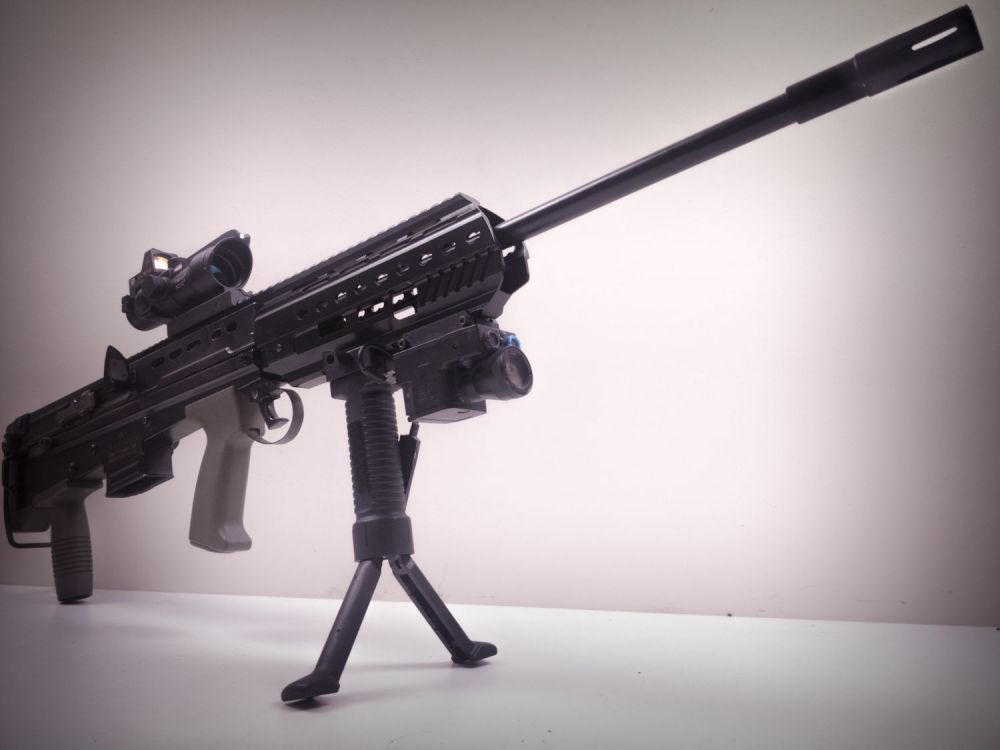

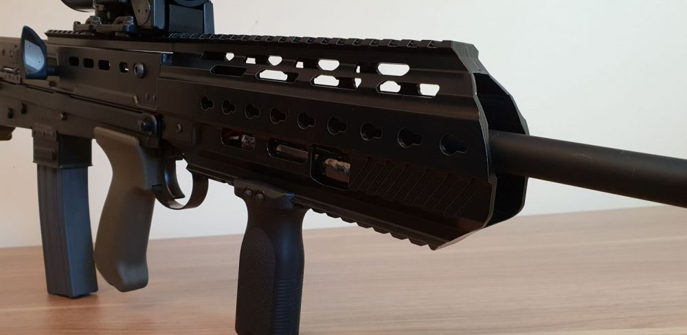

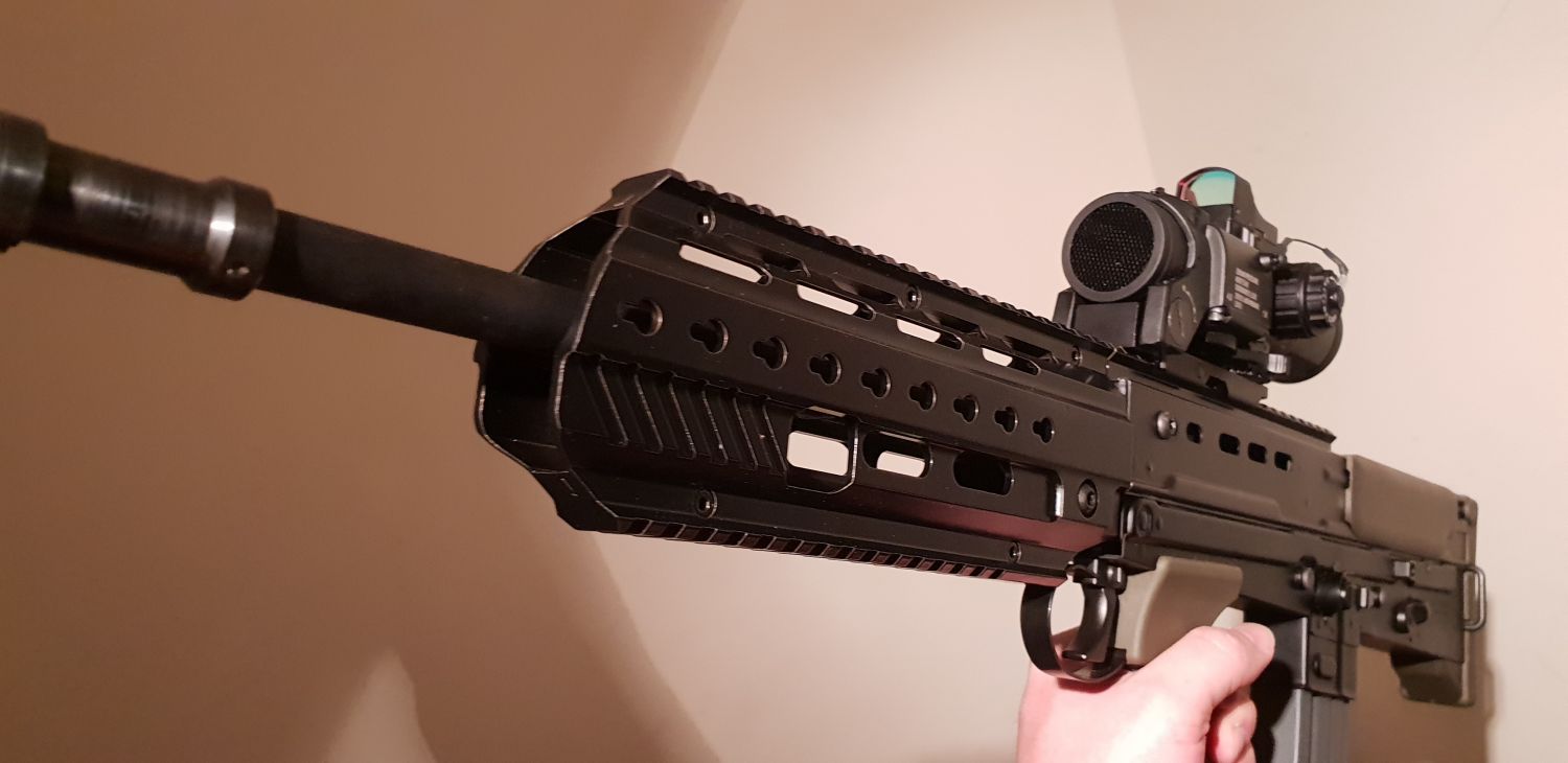

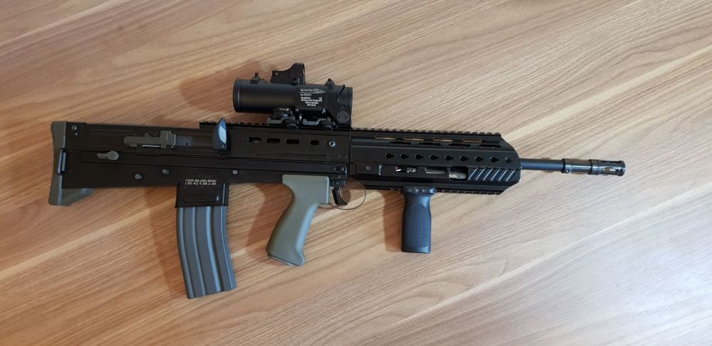

Hi Guys,
I just got my EK3 upgrade kit and converted my G&G L85A2 kit over to an L85A3.  For anyone thinking about upgrading their A2, I recommend giving this kit a go.  Its well built, and extremely solid.  Matches my G&G L85 extremely well, so you wouldn't know its an aftermarket mod.  Zero play or wobble to either the handguard or the picatinny optics rail, and doesn't seem like it will develop any play any time soon either!
The install took me about 1.5 hours, and English Kiwi, who designed the kit, has a video install guide up that walks you through.  If you are familiar with stripping an L85 it would probably only take half an hour or less, but this was my first time doing it.
Honestly the rifle looks great with this kit fitted.  It feel solid, the picatinny attachments are very useful, there is a lot more battery space than the A2.  Am pretty happy with the result!
Any questions people have, feel free to ask.
Have more pics if anyone wants to see.

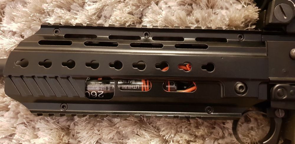

Battery space is much improved.  With the A2 handguard I couldn't get one of my 7.4v Titan batteries in as they are slightly larger dimension than the usual lipo size.  With this handguard I can get one 7.4v Titan in below the barrel, or a 11.1v Titan nunchuck in, half below and half above the barrel, if you are careful with the wiring.  Attached pic with the 7.4v in positioned so you can see it better (its in the 2nd and 3rd pic of the original post but less visible.
The G&G wiring has a short removable section that runs from the ETU in the lower, through a cut out just under the outer barrel, and into the handguard.  Thats all still there with the EK3 rail attached, so you just slide the battery into the front of the rail and connect it up.  You can remove the rail to get better access to the wiring if you need.

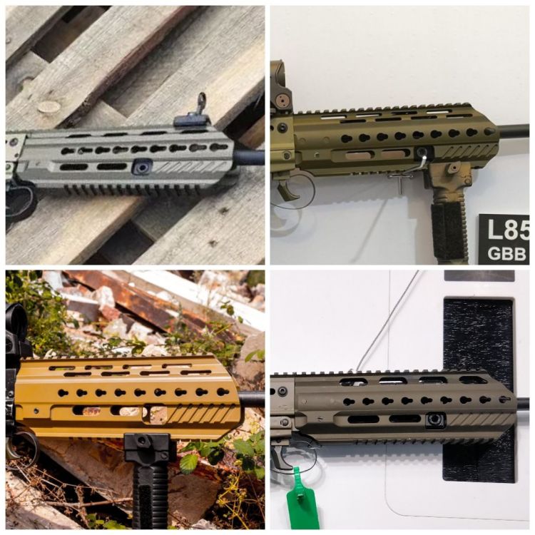

Hey it's the designer here! It's not so much as wanting to create my own mechanism for mounting as much as I was trying to emulate Hkey as closely as possible. Unfortunately the spec for Hkey is not readily available so I didn't the best I could there. In my opinion the visual differences between, keymod, cutdown keymod and EKey (my homage to Hkey) is fairly substantial (picture attached clockwise from top left: keymod, shortened keymod, A3 prototype rail, EKey).
I was very open with the community throughout the development process and asked for input into the design with and found it was almost a 50/50 split between keymod and EKey. In the end I went with EKey as a way to separate my development from the Angry Gun development :)
I agree that it shouldn't have flat sided, it was a bit of a shock to me when I saw the first production ones (I'm based near Cambridge and the manufacturer is based on the south coast) unfortunately the re-work costs would have been prohibitively expensive for this first batch however they have taken my feedback onboard and will be looking to bring back the curve for later batches!
I'm in the process of designing EKey mounting segment and my hope is I can just provide new lugs to go into existing keymod sections to allow for a wide range of accessories to be used! Hope this helps :D

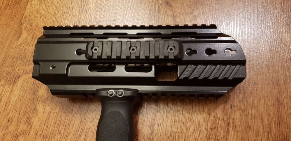

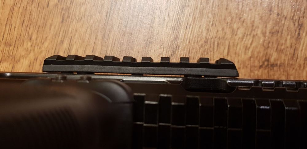

Just to wade back in on the keymod fitting issue... I just fitted a PTS keymod rail section with no issues.  How?  Just use the larger EKey openings for the mount points and pop them in from the reverse side.  Job done.  Pics below.
