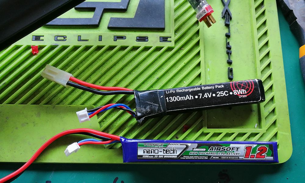

Speedbird_666 Posted July 28, 2020 Posted July 28, 2020 You can also use these (Cheaper, slimmer and Deans Connectors fitted as standard) https://hobbyking.com/en_us/turnigy-nano-tech-1200mah-2s-25-50c-lipo-airsoft-pack-t-connector.html I have both Hobbyking and the Vapex ones in the Component Shop link above. Both will fit in an Edge buffer tube . The Hobbyking is fractionally longer, but much slimmer, and still sits fully in the 'tube. I would recommend the Hobbyking ones over the Vapex ones, not for fitment, but for performance. They definitely kick out more power - less voltage sag under load. Be careful with the Gate X-ASR, with both batteries you will have the MOSFET, connectors and wiring sticking out the end (pictured). You could do some damage if you forget and try and fully collapse the stock with force. Pics of the batteries in my son's Specna Edge (E08):
