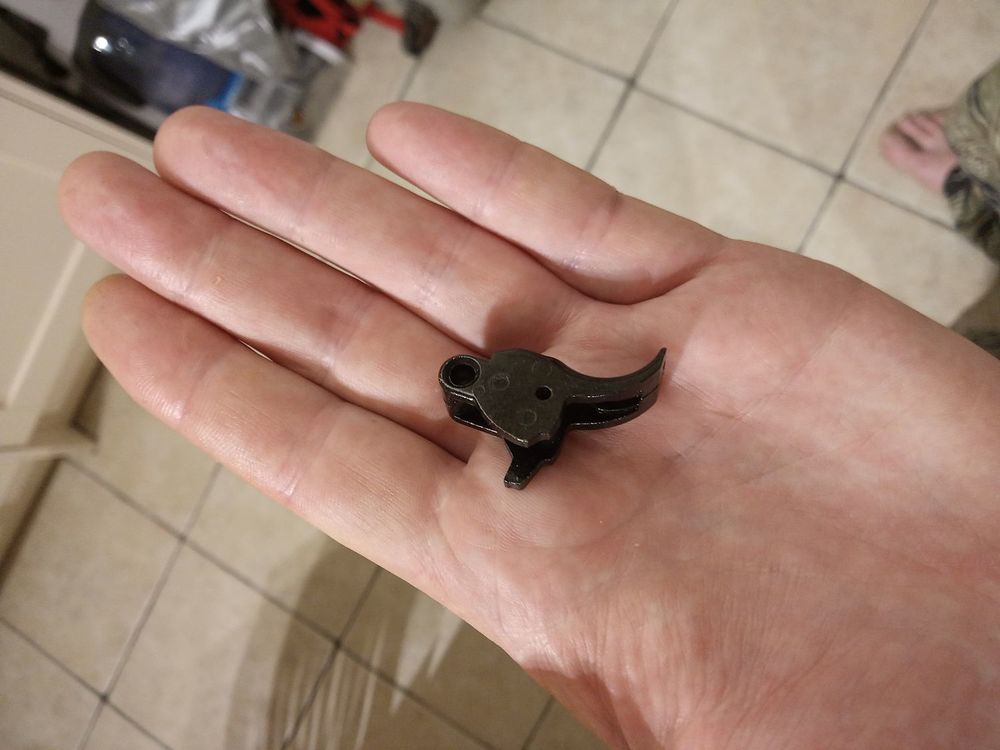

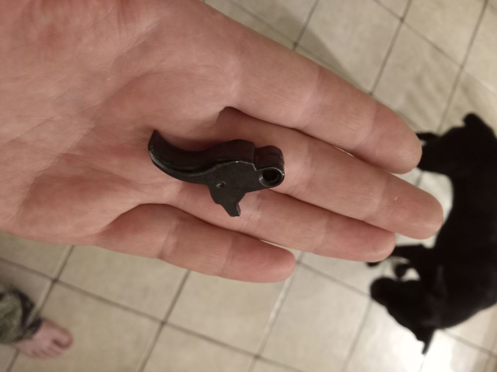

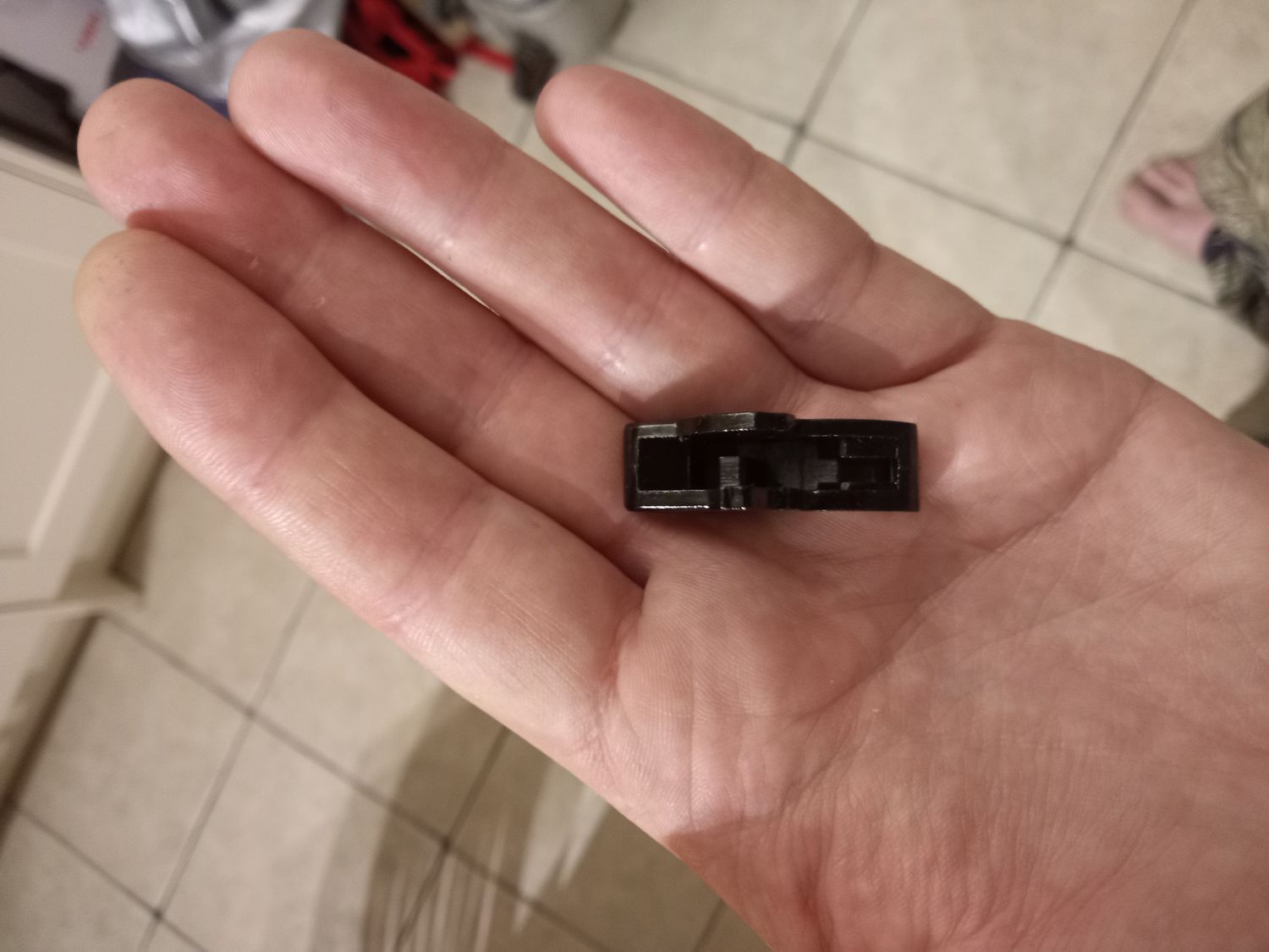

In the workshop today with much investigation i sorted the issue / design flaw i happened across. It definitely pumps out BBs now, well happy. Had about 30 mags through it now!
I will strip it down again now its all sorted and just do some house keeping in side, smooth everything so its operation is Uber slick.
For any potential owners/tinkerers be very aware if you remove the hammer assembly from the frame, this spring is retianed with absolutely nothing!
The offending aforementioned triangular follower can be seen at the very top.
