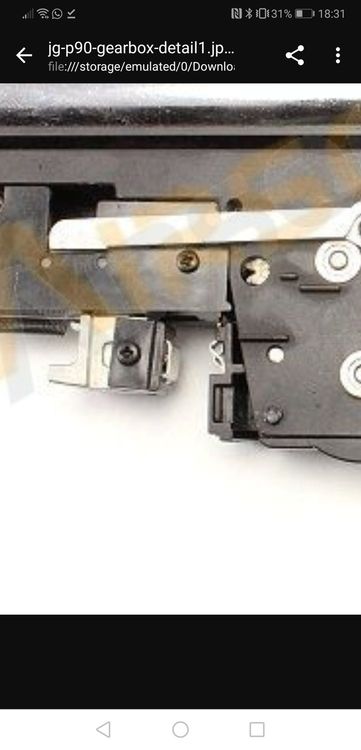

Ad_ Posted May 22, 2020 Posted May 22, 2020 There are two sets of contacts; one that gets disconnected by the cutoff lever after firing and another set further back that are used for full auto fire. When you fire the P90, a half-pull of the trigger only engages the first set of contacts so it only fires a single shot. Pulling the trigger completely engages the second set of contacts so it continues firing. The fire selector simply blocks the trigger from being pulled back completely when it's set to semi auto mode.
Barryelliott Posted May 28, 2020 Author Posted May 28, 2020 Thank you all for your answers you have been helpful. But just to clear something up. There is a pic attached (I hope) the 2 prongs that connect with the metal bit that slides back if I was to remove/block one of them does that block the full auto?. Thank you all
Davegolf Posted May 28, 2020 Posted May 28, 2020 Yes that is correct. Why do you need to lock it to semi, this is most unusual for an indoor site. Also AFAIK all the P90's I've had don not have two stage triggers, AKA the Aug trigger.

Barryelliott Posted May 30, 2020 Author Posted May 30, 2020 On 28/05/2020 at 20:37, Davegolf said: Yes that is correct. Why do you need to lock it to semi, this is most unusual for an indoor site. It's just how the rules have always been I think it's more because it's a very tight space arena. every p90 I have had in the past the selector has never worked you pull the trigger back and if you don't release it the moment a shot goes off it proceeds to go full auto
Ad_ Posted May 30, 2020 Posted May 30, 2020 That will eventually happen when the cutoff lever has worn down to the point that it can no longer release the trigger contacts after firing - none of these mods to restrict it to semi-auto only will help when that happens and the only way to fix it would be to install a new cutoff lever. Get a good quality P90 (I would expect the cheap versions to fail a lot sooner rather than later) and keep it well maintained and it shouldn't be a problem for a long time.
