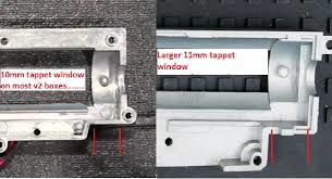

that is a before/after of what I do on V2's where you have less tappet retraction than on v3's
as on v3's the resting point of the tappet is further forward, thus the total tappet travel is greater
(so you effectively have more wiggle room to begin with on v3 than v2's)
Most tappet plate fronts are about 3mm, so you have 10mm - 3 = 7mm nozzle retraction max on v2
or on a v3 you have at least 11mm which means you have 8mm nozzle retraction
(sanding tappet front on SHS to say 2.5mm only assists sealing against bucking - does nowt for feeding)
With delayer I suggested, you retract the tappet a whisker more, the trimming of fin is just trying to keep the return timing about the same - especially in higher speed builds as max retraction was attained at say 9:30 so anything beyond the 9:00 or deffo 8:30 o'clock is nozzle returning
