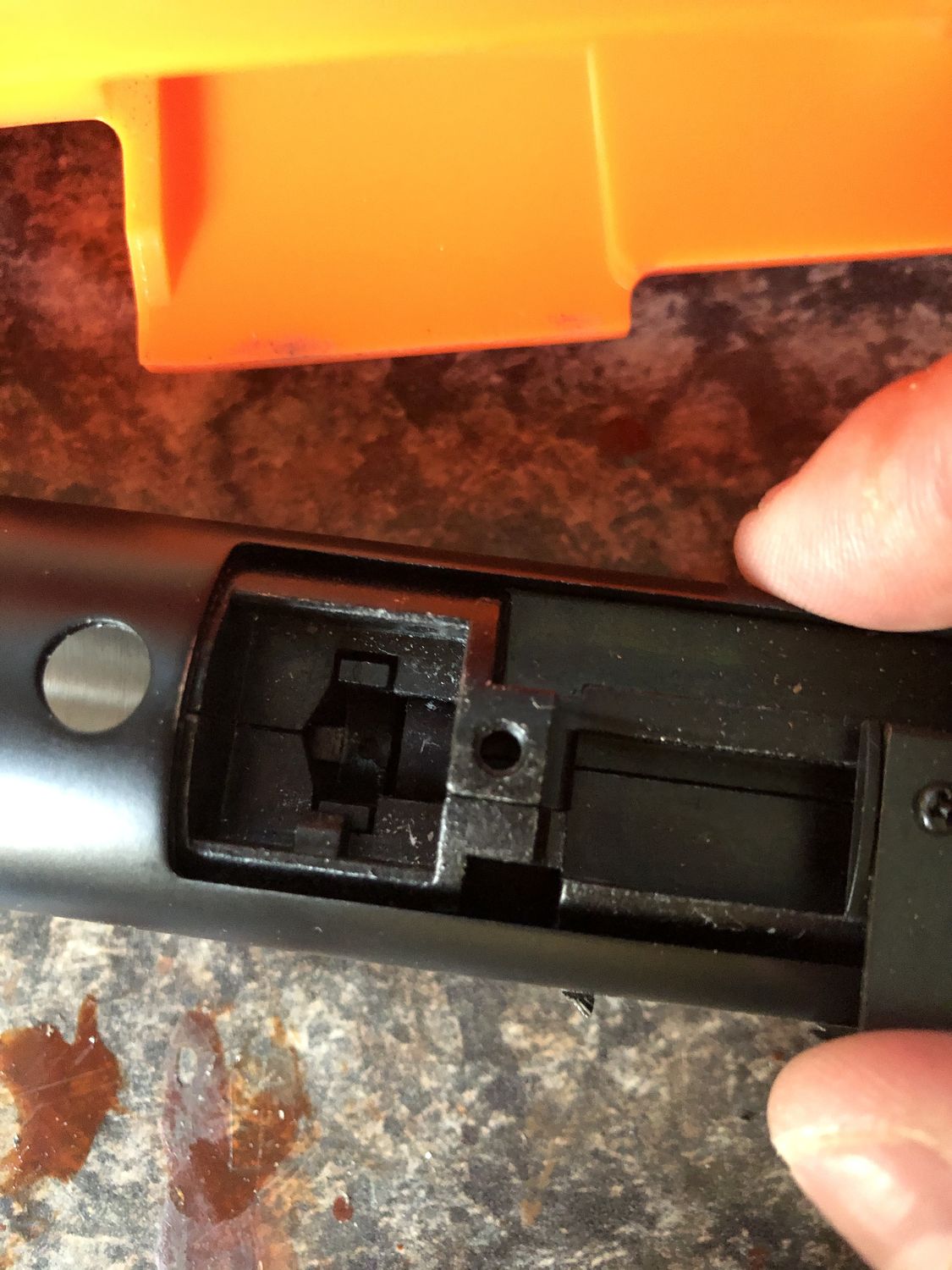

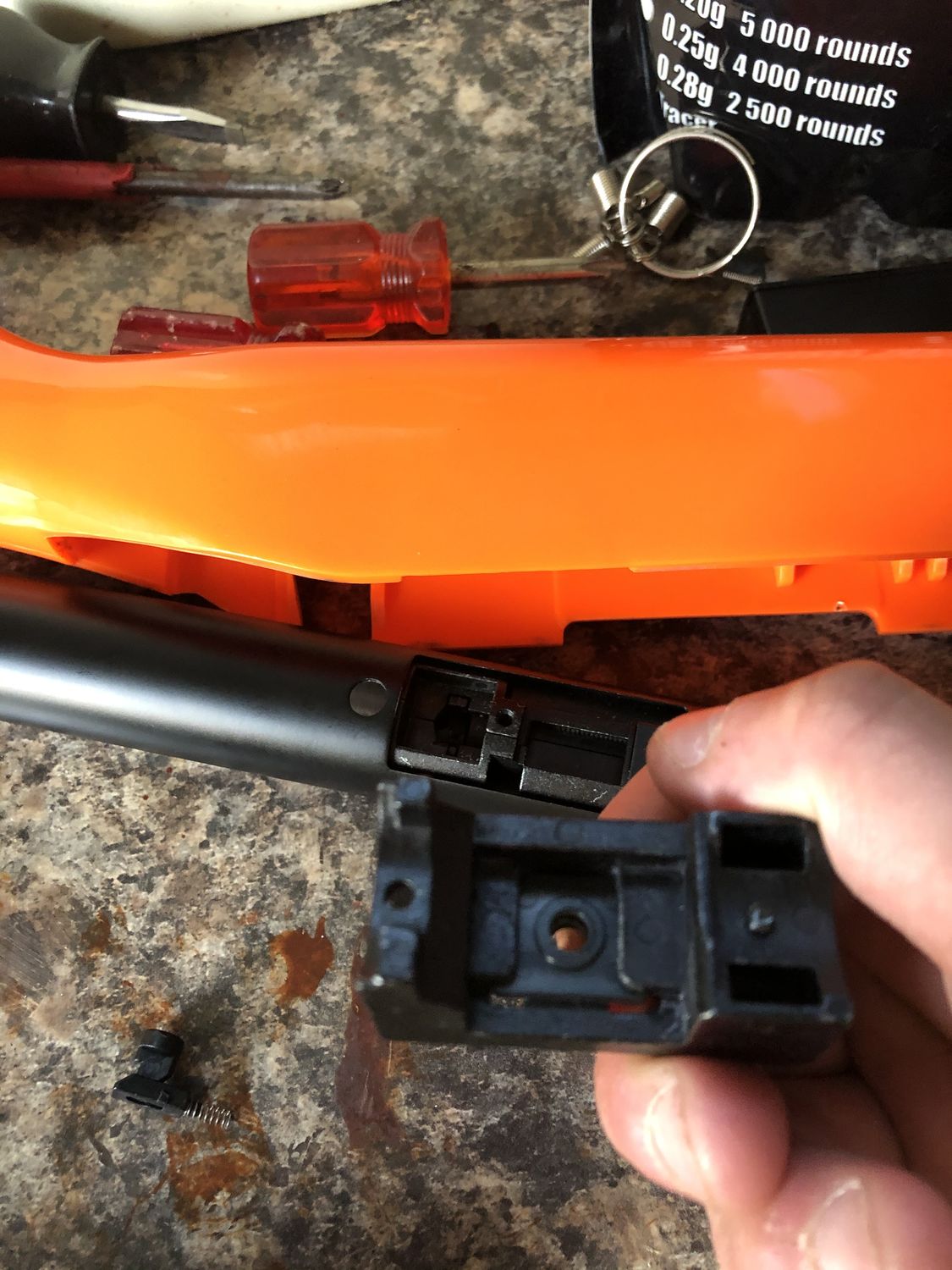

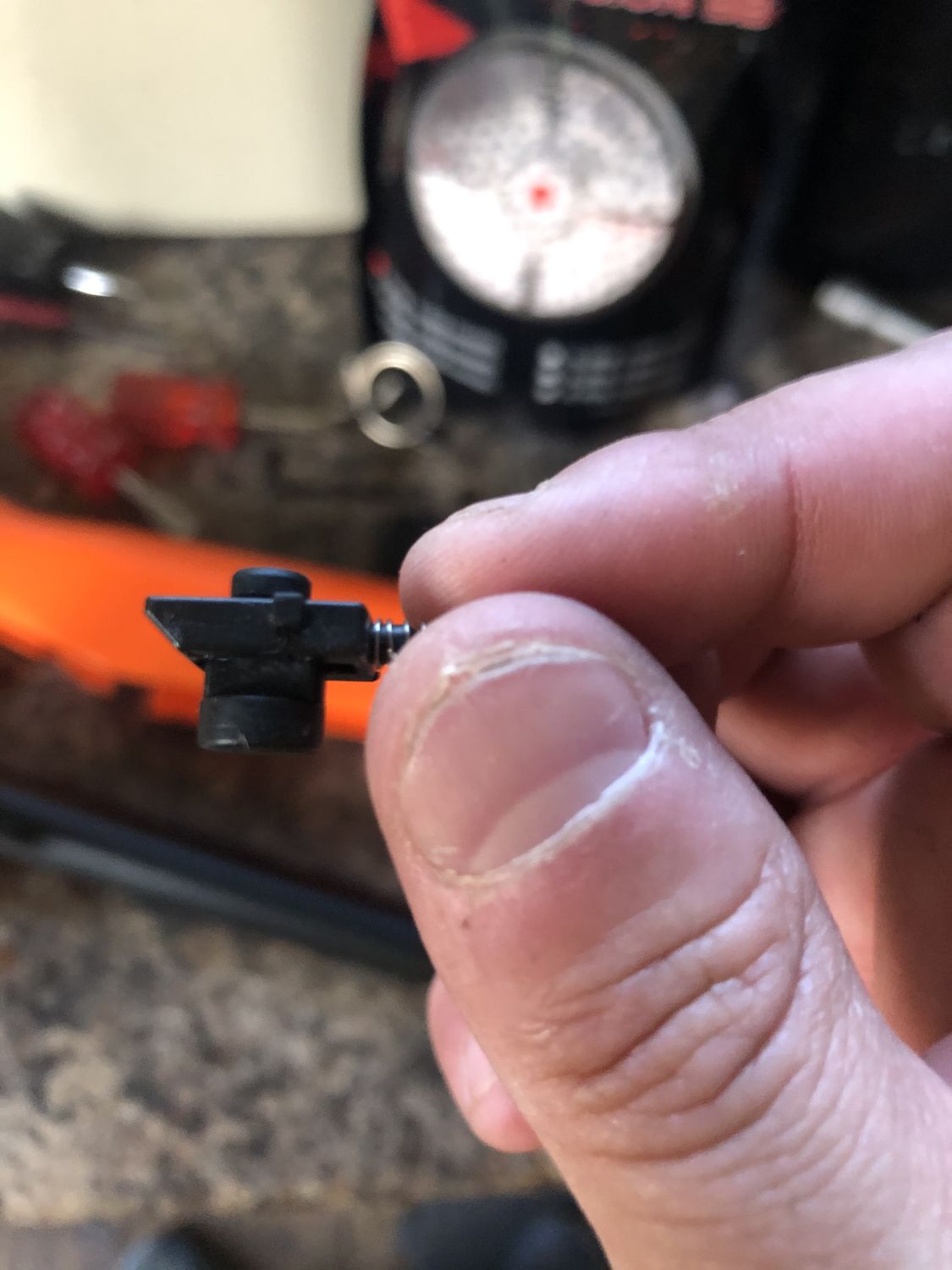

Dannyc92 Posted April 24, 2020 Author Posted April 24, 2020 I managed to get the screw out, used a hammer and a flat head screw bit and then screwed it out. When I took it apart, it looks like the nub just fell out onto the worktop in front of me, just need to figure out where exactly it goes on this. heres some pics of the hop up on this, have to get a smaller screwdriver to get the hop lever off so I can take it out of the barrel Here are a couple of videos of test firing too, one without my finger over the end and one with, the clunky spring sound is what I’ve heard when I’ve loaded a bb into the chamber and tried to fire IMG_0830.MOV IMG_0829.MOV
