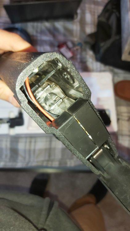

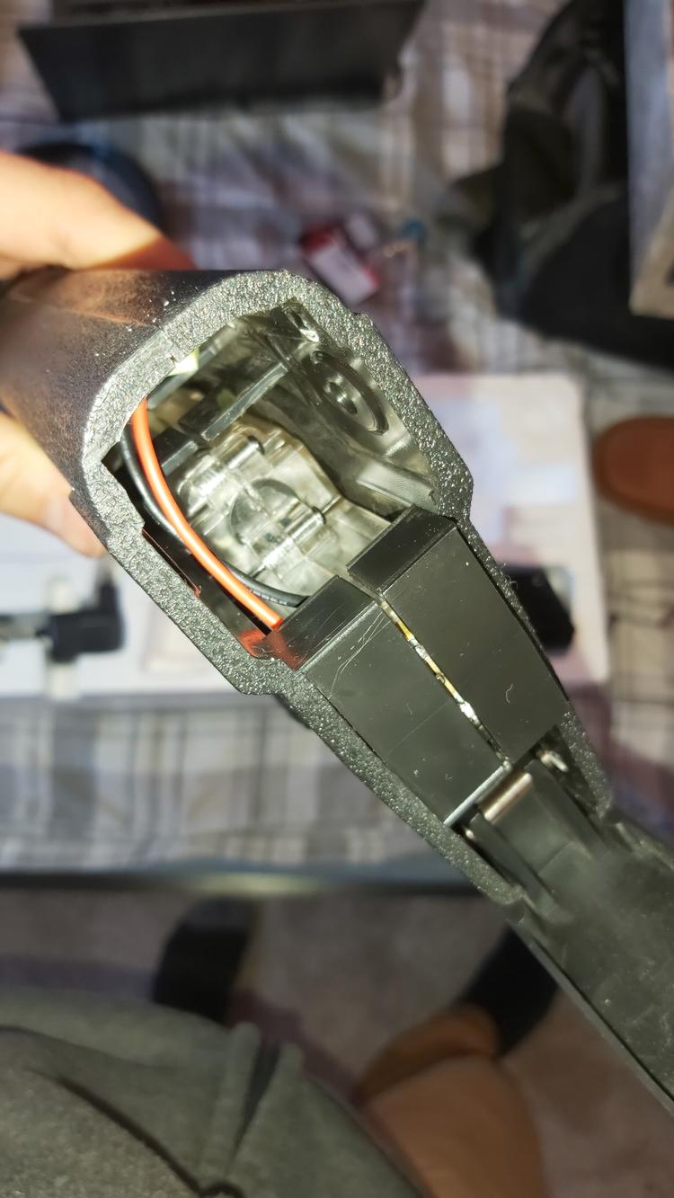

Hey guys I recently became interested in the X95 for a project im wanting to do. Does anyone have images of the gearbox itself?
For some backstory im wanting the X95 to do up like the S25-R on First Assault. Only differences are the height of the rail on the front forend and the military style handguard.
