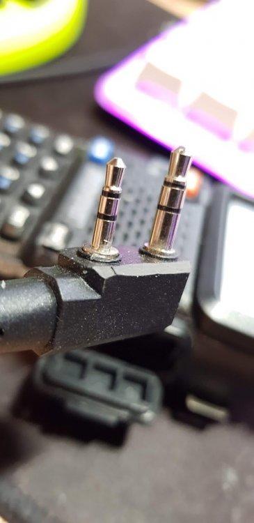

Monkman Posted January 13, 2020 Posted January 13, 2020 I have both the standalone & Helmet version. (Mine are two years old, I think they are on MOD2 or MOD3 now) **I love them, sound amplification is such a game changer and also protection from Pyro in CQB helps... Be aware some peeps have issues with the PTT. With the Earmor PTT Kenwood lead. (Assuming your going to get a Baofeng UV5R radio) There is a simple mod you can do as sometimes when pushing the PTT you won't transmit. (See the video below.... **Top comment also has a fix) Someone else showed me what to do in person. I just shaved a little off and boom worked fine! ***My mate though, his worked fine without any mods..so could've been a batch issue...don't know what the more up to date PTT kenwood connector cables are like though)

Uncle Pauly Posted February 10, 2020 Author Posted February 10, 2020 So, I now have a set of Earmor M32H (Mod 3 version) and have encountered a problem. Here’s my set up: Earmor M32H Headset > Earmor M51 PTT > Midland G18 radio (2-pin Motorola). The problem is that when everything is connected as above (i.e. headset to radio via PTT): The radio receives fine - I can hear incoming transmissions over the headset, but… The radio is unable to transmit using the PTT. If I press the PTT button and use the headset mic, nothing is transmitted (and the transmit indicator light on the radio remains off). Same if I press the transmit button on the radio itself with the PTT cable plugged in. Nothing. The radio otherwise works fine without the PTT plugged in: transmits and receives like a charm. Any idea what the problem might be? Perhaps the same issue mentioned by @Monkmanabove? Or maybe the Earmor M51 isn't compatible with the Mod 3 headsets? (a newer M52 version of the PTT is available). I've read a comment on Amazon that suggests this. Cheers for any wisdom on the matter ? PS: I got myself a FMA "FARA" kit and it's waaay better than the original headset mounts. Thanks @Lozartfor the heads up on that!
Monkman Posted February 10, 2020 Posted February 10, 2020 I know it's two different radios...but I had to do this to get my PTT to work reliably with my Baofeng radio.... I just trimmed the rubber on one side of the Kenwood connector. Have a real close look at the connector..is it not seating absolutely perfect? Have you pushed down hard on it, then pushed the PTT button with you other hand? None of this may help..but thought i'd mention it anyway.
Uncle Pauly Posted February 10, 2020 Author Posted February 10, 2020 ^ Thanks bud. That photo is really useful ? I’ll investigate and attempt some whittling of the connector head if looks like that could be the problem (good tip about putting some pressure on the connector and trying the PTT).
Uncle Pauly Posted February 18, 2020 Author Posted February 18, 2020 So... it turns out that the Midland G18 radio isn't compatible with the Earmor PTT. I haven't had a definite answer on this - I've simply tried two different Earmor PTTs and neither worked with the G18 handset, which is good enough evidence for me (I checked the seal between the 2-pin connector and the handset on both occasions and it was snug, so I don't think this is the same issue as reported by @Monkman... but thanks again for the heads up on that). As a Plan B I've bought a Kenwood version of the Earmor PTT to work with a Baofeng UV-5R (which I already had) and to 'ease my conscience' I've also picked up a PMR446-compliant Retevis RT24 - cheap, cheerful and Kenwood/Earmor compatible, making it what appears to be a license-free equivalent of the Baofeng. I've yet to test it, but reviews seem promising. As ever, this has proved to be vastly more faffy than I had envisaged. But I seem to have got there in the end, if only through trial and error ? PS: my Midland G18 is now up for sale if anyone's interested. It's a great quality radio - waterproof and extremely rugged. Might end up keeping it myself for general-purpose hiking and biking use. For anyone who might stumble on this thread at a later date, here's the list of Earmor PTT-compatible radios: Motorola and Kenwood versions. You can find lists for other connector types on the product listings over at http://emperionstore.com and elsewhere. Earmor PTT - list of compatible radios that use the Motorola 2-prong connector: * XTN Series: XTN446, XTN500, XTN600 * XTN XV Series: XV1100, XV2100, XV2600, XV4100 * XTN XU Series: XU1100, XU2100, XU2600, XU4100 * XTN AX Series: AXV5100, AXU4100 * CLS Series: CLS1110, CLS1410, CLS1413, CLS1450, CLS1450C, CLS1450CB, VL50 * Spirit Series: SV10, SV11, SV11D, SV21, SV12, SV22, SV22C, SU210, SU22, SU22C, SU220, Spirit Pro, Spirit Pro+, HP10 * Spirit MU Series: MU11, MU11C, MU11CV, MU12, MU12C, MU12CV, MU21C, MU21CV, MU22CVS, MU24CV, MU24CVS, MU24CVST * Spirit MV Series: MV11, MV11C, MV11CV, MV12, MV12CV, MV21C, MV21CV, MV22, MV22CV, MV24CVS * CP Series: CP88, CP040. CP100, CP110, CP125, CP150, CP200, CP250, CP300 * GP Series: GP2000 , GP2100, GP300, GP308, GP68, GP88, GP88S * SP Series: SP10, SP21, SP50+, SP50 * CT Series: CT150, CT250, CT450, CT450LS * P Series: P040, P080, P110, P1225, P1225LS * DTR Series: DTR410, DTR550, DTR610, DTR650 * Other Series: GTI, GTX, LTS2000, VL130, PMR446, ECP100, PR400, MagOne BPR400, EP450, AU1200, AV1200 * RDX Series: RDV-5100, RDV2020, RDU2020, RDU2080DD, RDU4100, RDU4160D, RDV2080D, RDV5100 Earmor PTT - list of compatible radios that use the Kenwood connector (NB: of this list, only the Retevis RT24 is PMR446 license-free). Kenwood: TH-F6/F6A/D/D7A/D7AG/D7E/F/F7E/G71/G71A/G71E/K2/K2A/K2E/ K2ET/21/ 21AT/21BT/22/22A/22AT/22E/25/26/27/28/31AT/31BT/41AT/41BT/42/42A/ 42AT/2E/45/46/47/215/225/235/235A/235E/315/415 TK-208/220/240/240D/248/250/260/260/270/370G/372G/373G/320/340/340D/348/350/ 378/378G/430/431/353/360/2100/2102/2130/2160/3100/3101/3102/3107/3118/3130/3131/3160 etc Kenwood:TK-2170/3170/2312/3312/2360/3360/2400/3400/2400V/3400U/2402/3402/2402V/3402U/3173 Kenwood ProTalk :TK-2400VP, TK-3400UP, TK-3230XLS Kenwood:TH-F6A, TH-D72A, TH-K20A Kenwood:Nexedge NX-220, NX-320, NX-240V, NX-340U, NX-420 Baofeng: UV-Series,UV-3R PLUS, UV-5R/5RA/5RB/5RD/5RE/5R V2+/5R5/5X5R+ Plus/8/8D/B5/B/82HP/82L/82/82C/89 BF-480/490/320/V6/520/530/999/888/777/666S/777S/888S/gt-3tp/bf-f9-v2hp+ WOUXUN: KG-UV1D/KG-UV2D/UVDIP/KG-669/659/679/689/639/699/801/kg-uv8e QUANSHENG: TG-K4AT/2AT/22AT/45AT/42AT/25AT/UV HYT:TC286 386 2685 3865 6685, TC 278 378 388, TC 2100 2088 TYT 2 Pin Retevis:H-777,RT1, RT2,RT3, RT5, RT7, RT-5R,RT-5RV,RT-B6,888s, RT24 Linton:LT-2288/3288/6288/5288/3188/2188/3260/2268/3268/6288/6188/3288A PUXING Radio: PX-666/777/777 PLUS/3288/-888 Hytera Radio:TC-268/268S/270/270S/368/368S//370/370S WEIERWEI:VEV-3288S/6288/3288
