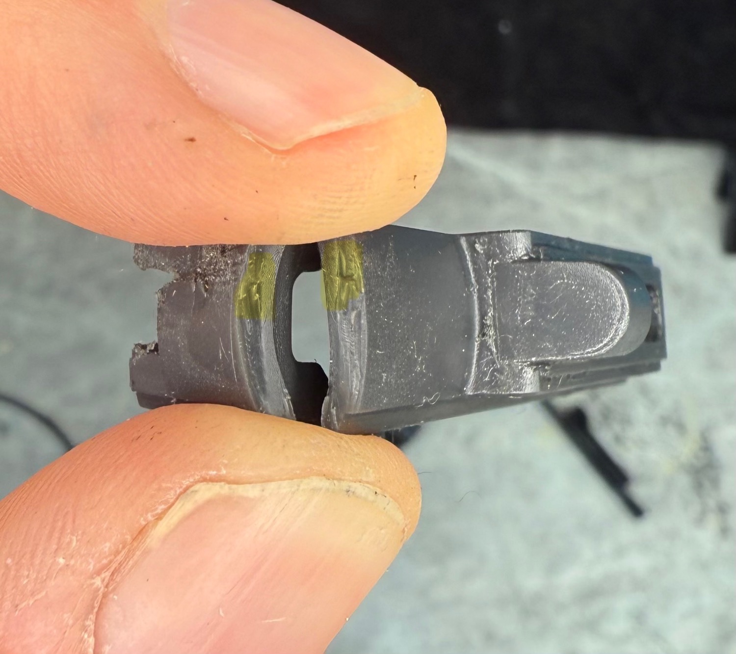

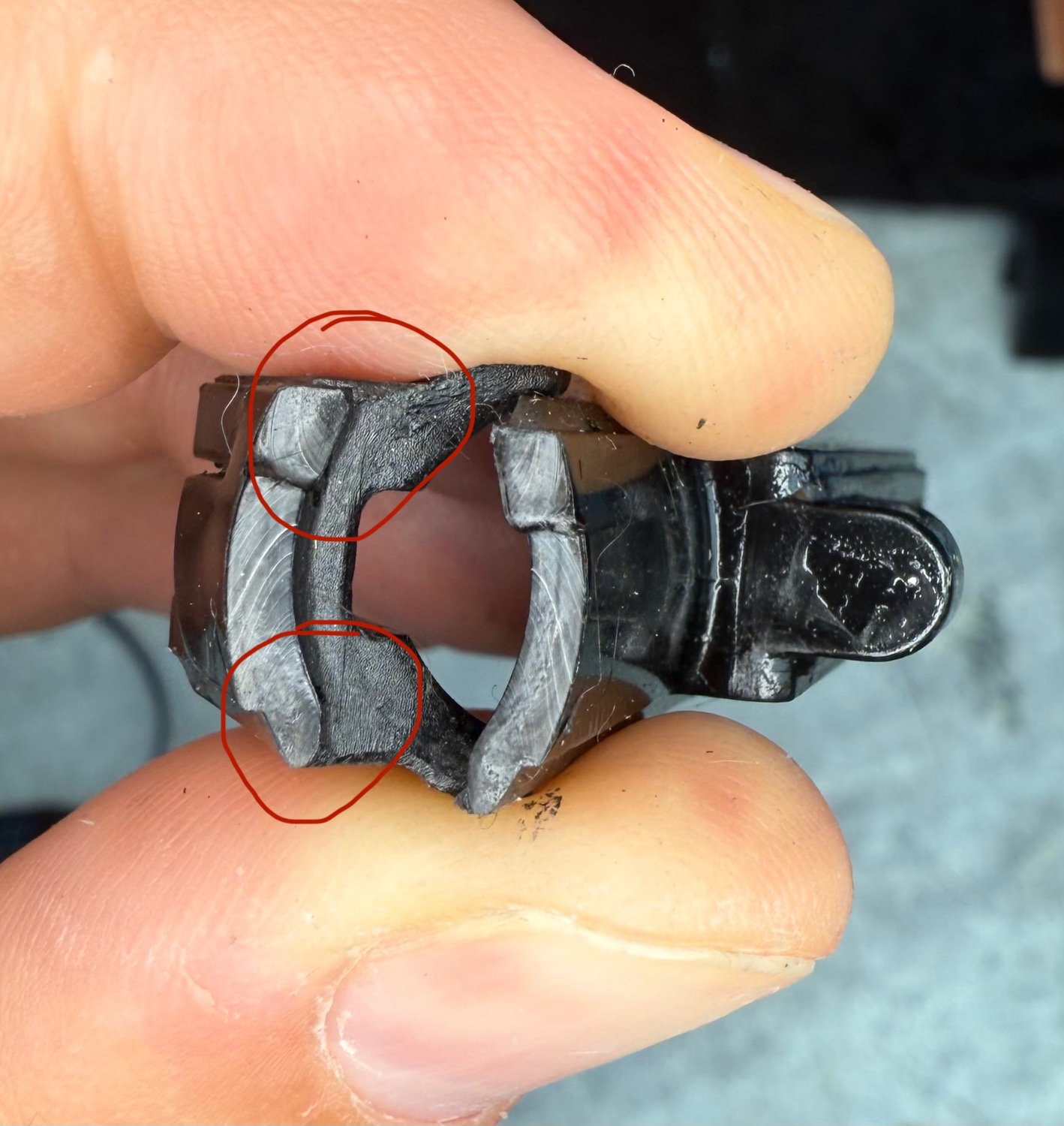

SSPKali Posted July 16 Posted July 16 (edited) Had a couple of odd failures recently - broke a nozzle guide (think it was AG) snapped off the front part that sits in the BCG and guides the nozzle. Not surprised AG item broke so popped a spare GM one on. That failed tonight when I was checking the FPS. Again snapped in the same place! Fitted my last spare, a G&P one, but took a small round file and added a radius to the inside corner where the others had failed. Now have a couple of Unicorn ones on order from JKArmy but will probably never need them ? Anyone else had this? Nozzle springs, nozzle feed pokey bit, hell even the tiny screw through the nozzle holding the internals in….just never seen one of these fail before! UPDATED: The Guns Modify failed at the sharp corner and cracked there (circled red areas) then slowly got worse and worse over next X shots as shown by the rough, almost tree ring lines, area across the middle 80% The Angry Gun one (grey) broke rapidly (as evidenced by lack to brassing / tide marks as on the GM one) and appears to have failed at the inclusion / void highlighted. AG had radiused the corners…but then used shitty plastic Edited July 17 by SSPKali Evidence / pics
