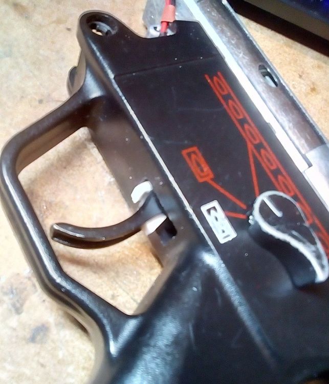

I'm deliberately bumping this topic as it's still one of the top Google hits for "airsoft MP5K trigger pull" / "V3 trigger pull" and similar.
Well, I put a bit of time into this.  The 2-piece trigger is always going to be a problem, as there's loads of slack in it before the 2nd part even starts to move forwards.  Then it has to move quite a long way back in order to reset the cut-off level.  It was easy enough to pre-tension by gluing a strip of plastic to the top front of the main trigger to stop it moving fully forwards / upwards against the gearbox, but this then stopped the semi-auto reset.
So eventually I hit on this pragmatic bodge: just stick pieces of cut up pencil eraser onto the trigger, which can be done with the gun fully assembled.
A piece on the front pre-tensions it, and you can also put a piece on the back to limit rearward travel and give a shorter total pull.  In both cases, hold the pieces in place while you work the trigger, and start with pieces that are too thick to allow triggering or resetting, then slowly pare them down until you get consisting fire-and-reset, and superglue in place.
It's still not what you'd call a short pull, but you can improve the stock pull a fair bit with very little time and effort. If it starts acting up on game day, just rip the rubber out and you're back to stock.
The pieces of white rubber are still unpainted here to make it clear what I've done - a dab of black will hide the bodge.
