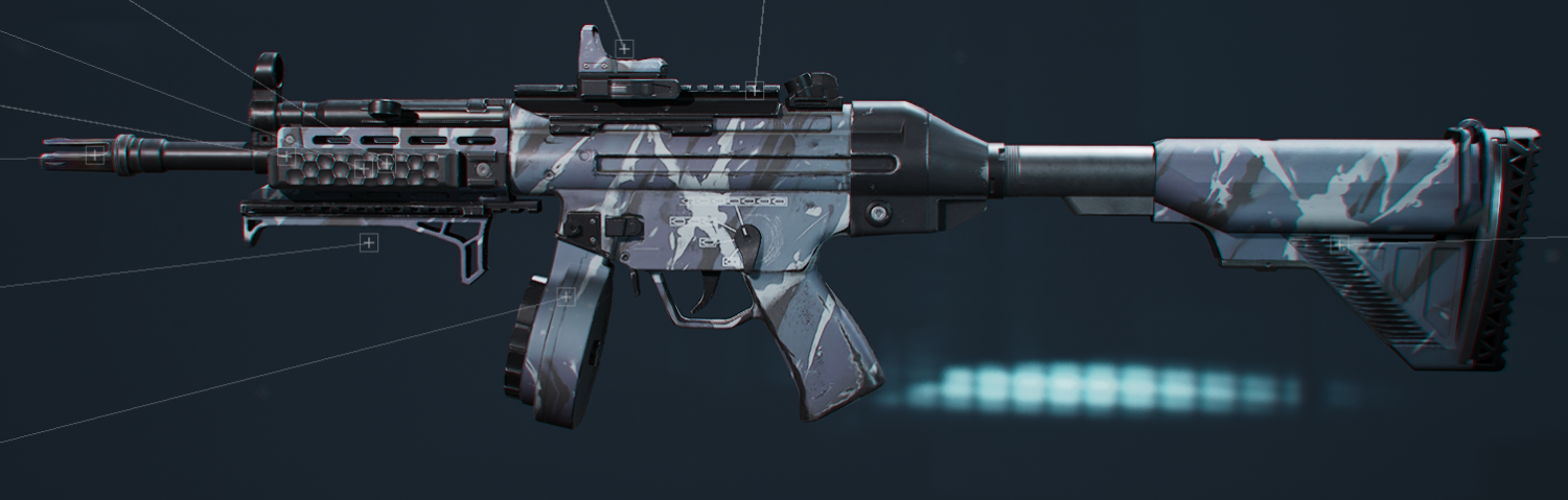

I am considering purchasing an MP5 (AEG) but I require some help with the components since I want to customize it to resemble the loadout I made in Delta Force.
Can anyone help me find anything similar to the components in the screenshot? Thanks!
If the screenshot below doesn't show enough, I can take more.

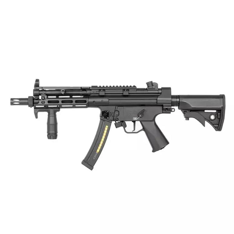

Cyma CM041 H with some rail covers will get you most of the way there.
fb8cef0833360bf1c5961f041c5c4884ce059ff6__55418.thumb.jpg.82f194439603ba88b477677d4412378f.jpg

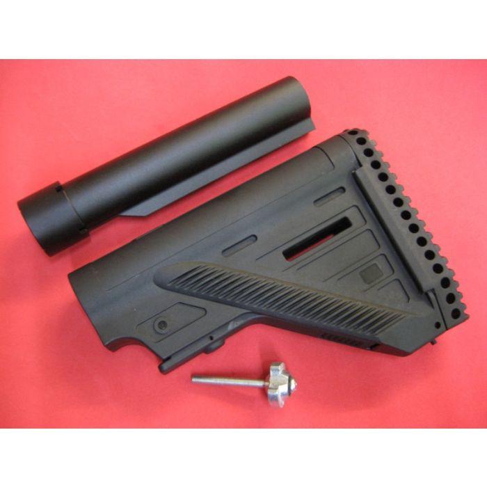

Then HK 416A5 stock:
Then it's that forward grip thing, drum mag, red dot sight and a barrel extension + flash hider.
https://www.combatsouth.co.uk/cyma-cm041-h-mp5-with-m4-style-stock-platinum-edition/
https://www.firesupport.uk/ec-hk-416-a5-stock-and-stock-tube.html

That's some nice kit and useful information you provided me with!
At first, I was thinking about the UMAREX MP5. Either the Elite Force H&K or the Heckler & Koch HK MP5 A5 Dual Power Spring, I don't know which one is better.
https://evike-europe.com/78863.html - Elite Force H&K
https://evike-europe.com/2-6311.html - Heckler & Koch HK
As for the front grip, I believe I can use a Magpul AFG or something 3D printed.
The only problem I have is the extended barrel, which might not be so easy to find.
But thank you for the help, I will consider your advice!

I have acquired the Cyma CM041 H and it's a beauty. Unfortunately, the Tokyo Marui drum mag does not fit.
Now I shall begin my quest for a longer outer barrel and a good adapter for the drum mag.
