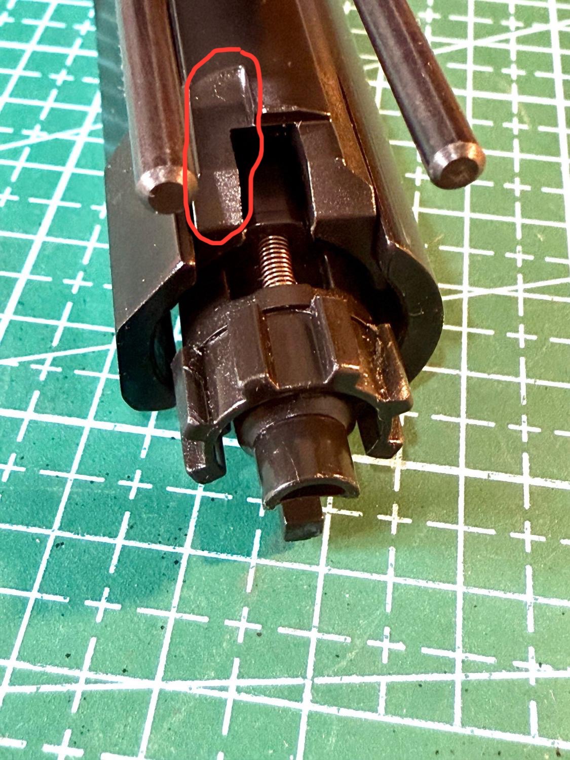

yojimbo Posted April 4 Author Share Posted April 4 7 hours ago, SSPKali said: The hop seems to be adjusting itself. This could be the nozzle guide on the top of the bolt carrier rubbing the hop wheel as it moves forward. There should be a small scalloped section, try fettling that a bit and see if that sorts it. Hi, thank you for taking the time to reply. On the photo I have attached, can you please indicate what I need to remove please? I would really appreciate it. Many thanks in advance. Link to comment Share on other sites More sharing options...
SSPKali Posted April 4 Share Posted April 4 The part circled in red is the cut out for the hop up wheel. To make more room you can either carefully file out some more or make the bolt carrier and nozzle guide run “lower” in the upper receiver. Hao achieves this with their BCG stickers for example. Link to comment Share on other sites More sharing options...
yojimbo Posted April 4 Author Share Posted April 4 2 minutes ago, SSPKali said: The part circled in red is the cut out for the hop up wheel. To make more room you can either carefully file out some more or make the bolt carrier and nozzle guide run “lower” in the upper receiver. Hao achieves this with their BCG stickers for example. Are you talking about putting stickers in the bottom of the charging handle or in the upper where the charging handle sits? If I file out the are you marked with the red circle, are we talking a 1 or 2 mm or more of a chunk? (p.s. is this something you have experienced before) Thank you again Link to comment Share on other sites More sharing options...
SSPKali Posted April 4 Share Posted April 4 1 minute ago, yojimbo said: Are you talking about putting stickers in the bottom of the charging handle or in the upper where the charging handle sits? If I file out the are you marked with the red circle, are we talking a 1 or 2 mm or more of a chunk? (p.s. is this something you have experienced before) Thank you again Hao put the sticker on the upper left face of the BCG (opposite side to the ejection port) it probably needs less than 1mm removing, best to take a little off and try rather than going mad with the angle grinder! I have experienced it with certain combinations of nozzle guides and charging handles. The old worn TM guide and handle was bad for it. Once replaced and the sharp edge taken off the cut out I have had zero issues Link to comment Share on other sites More sharing options...

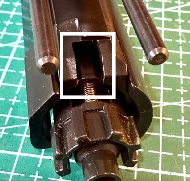

yojimbo Posted April 4 Author Share Posted April 4 24 minutes ago, SSPKali said: Hao put the sticker on the upper left face of the BCG (opposite side to the ejection port) it probably needs less than 1mm removing, best to take a little off and try rather than going mad with the angle grinder! I have experienced it with certain combinations of nozzle guides and charging handles. The old worn TM guide and handle was bad for it. Once replaced and the sharp edge taken off the cut out I have had zero issues This area in highlighted with the white square is called the nozzle guide? Thinking back, I had seen someone mention something about the gas key at the top of the bolt wearing and sometimes causing problems with the bolt height. I think it was on one of Ollie Talks airsoft videos, rip. Thank you again so much for your suggestions, will only take off a bit at a time and see what happens. Definitely a file and not angle grinder job lol Link to comment Share on other sites More sharing options...
SSPKali Posted April 4 Share Posted April 4 I think the “gas key” is the nub at the top of that part that fits in the underside of the charging handles. Obviously there are slight differences between the firearm and airsoft M4 designs so not a direct comparison 👍 Link to comment Share on other sites More sharing options...
ButcherBill Posted April 4 Share Posted April 4 Please be wary about taking too much off, I don't see any wear on the bolt carrier, if anything was rubbing there would be signs. Link to comment Share on other sites More sharing options...
SSPKali Posted April 5 Share Posted April 5 (edited) 22 hours ago, ButcherBill said: Please be wary about taking too much off, I don't see any wear on the bolt carrier, if anything was rubbing there would be signs. It probably won’t wear the nozzle guide much as it will naturally roll the hop wheel and not scrape across it. A non-destructive way of testing would be to put a long strip of gaffer tape in the channel in the upper receiver that the charging handle runs in. That will move the bolt down a hair and may stop the issue. Then at least you know the likely cause and can always peel the tape out after testing. Edited April 5 by SSPKali yojimbo 1 Link to comment Share on other sites More sharing options...
