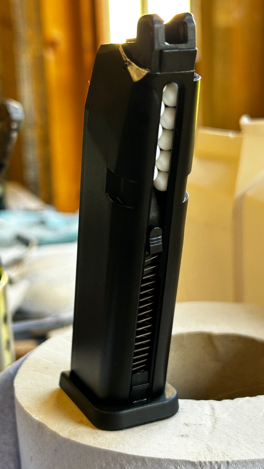

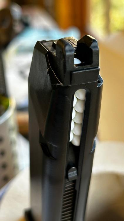

I bought myself an AAP-01C pistol and it’s great but the BBs don’t feed right to the top of the magazine.  Much fiddling and different BB brands have made no difference.  Are the stock springs on these crap and should I look for a better one? Are the tolerances in the top plastic part too tight?  Has anyone else had this issue and figured out why it happens?  Thanks for any info.
The original AAP mags do have weaker springs in comparison to, say, WE (coincidentally I was loading examples from each manufacturer this afternoon ready for tomorrow's game and it is noticeable). But I'd agree with the above - something not right with the feed lips.  If you have ruled out the bb follower catching/rubbing in the channel, then probably worth taking off the lips and giving them a gentle sand where the bbs feed through...
Yup, what they said. My AAP-01C's magazine feeds fine (and it will eat Action Army and WE mags). Get in there with a file or some rolled up sandpaper.
I used the rolled-up sandpaper technique to smooth the inside of the lower feed lips and it seems to have done the trick.  Thanks everyone.
