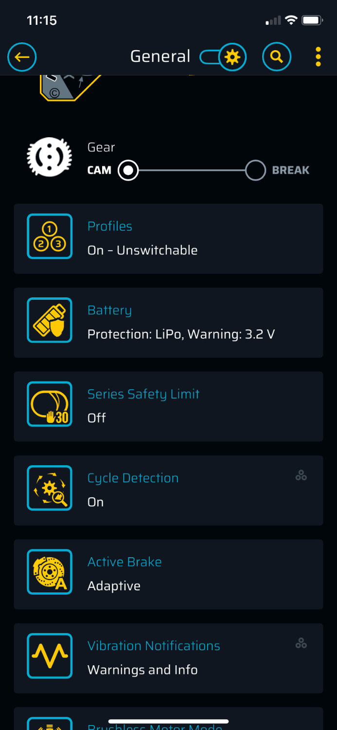

Fatboy40 Posted December 4 Share Posted December 4 31 minutes ago, strykerles said: I had a similar problem a while ago with an ak. Had a friend look at it and I think he said it was something to do with the cycle timing. works now though so whatever he did worked. I'd strongly suspect that it's a cycle control / active braking issue. @JinxDuh is cycle control enabled / in the GCS app on your smartphone do you see it correctly observing the sector gear teeth / what level of active braking do you have set? Link to comment Share on other sites More sharing options...
JinxDuh Posted December 4 Author Share Posted December 4 13 minutes ago, Fatboy40 said: I'd strongly suspect that it's a cycle control / active braking issue. @JinxDuh is cycle control enabled / in the GCS app on your smartphone do you see it correctly observing the sector gear teeth / what level of active braking do you have set? I'll reinstall it tomorrow and check/update the post! Link to comment Share on other sites More sharing options...

JinxDuh Posted December 5 Author Share Posted December 5 18 hours ago, Fatboy40 said: I'd strongly suspect that it's a cycle control / active braking issue. @JinxDuh is cycle control enabled / in the GCS app on your smartphone do you see it correctly observing the sector gear teeth / what level of active braking do you have set? Cycle control is enabled, active brake is adaptive as standard. Turning active brake to manual and setting it to 0 seems to have cured the issue? Fatboy40 1 Link to comment Share on other sites More sharing options...

LMKipper Posted December 5 Share Posted December 5 That will be your active braking heating the motor up. What happens if you just turn it off? Also could it be cycling too fast for the tappet plate? Do you need a delayer chip perhaps? Link to comment Share on other sites More sharing options...
JinxDuh Posted December 5 Author Share Posted December 5 1 hour ago, LMKipper said: That will be your active braking heating the motor up. What happens if you just turn it off? Also could it be cycling too fast for the tappet plate? Do you need a delayer chip perhaps? I couldn't see an option to simply turn off active brake, it had "Adaptive" and "Manual". I noticed my nozzle has a small chunk knocked out of it, so I think the nozzle may be getting caught up on the shell or hop unit. Going to change it out tomorrow and try with the mosfet again, worst case scenario I'll move my RPK gearbox out into the AK105 as the RPK is now sat in the corner after being replaced by the PKM 😂 Link to comment Share on other sites More sharing options...
pyromancer6 Posted December 5 Share Posted December 5 (edited) 1 hour ago, JinxDuh said: I couldn't see an option to simply turn off active brake, it had "Adaptive" and "Manual". If you set it to 'Manual' it'll come up with settings from 100% in 20% increments, just pop it down to 0% to turn it off. But yeah, the nozzle having a chunk missing might have something to do with the feeding issues you're having, if not I guess even asters are cursed now, not just titans Edited December 5 by pyromancer6 Link to comment Share on other sites More sharing options...
JinxDuh Posted December 5 Author Share Posted December 5 36 minutes ago, pyromancer6 said: If you set it to 'Manual' it'll come up with settings from 100% in 20% increments, just pop it down to 0% to turn it off. Yeah that's what I done haha 36 minutes ago, pyromancer6 said: if not I guess even asters are cursed now, not just titans Ironically the few pews I've put titans into have never had any issues! Link to comment Share on other sites More sharing options...
