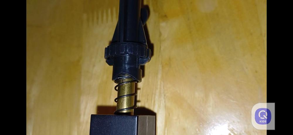

Update well I managed to figure out the mag is a hi cap, when the mag is in the and try to fire off a couple rounds the bbs just fall out the muzzle so I'm not sure if a new mag would work however upon checking the barrel to see that if it was blocked I happened to stumble across this I appears a piece of the hop unit has broken off would this be that's causing my issue?
