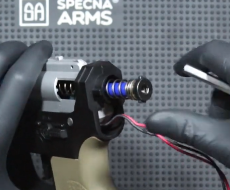

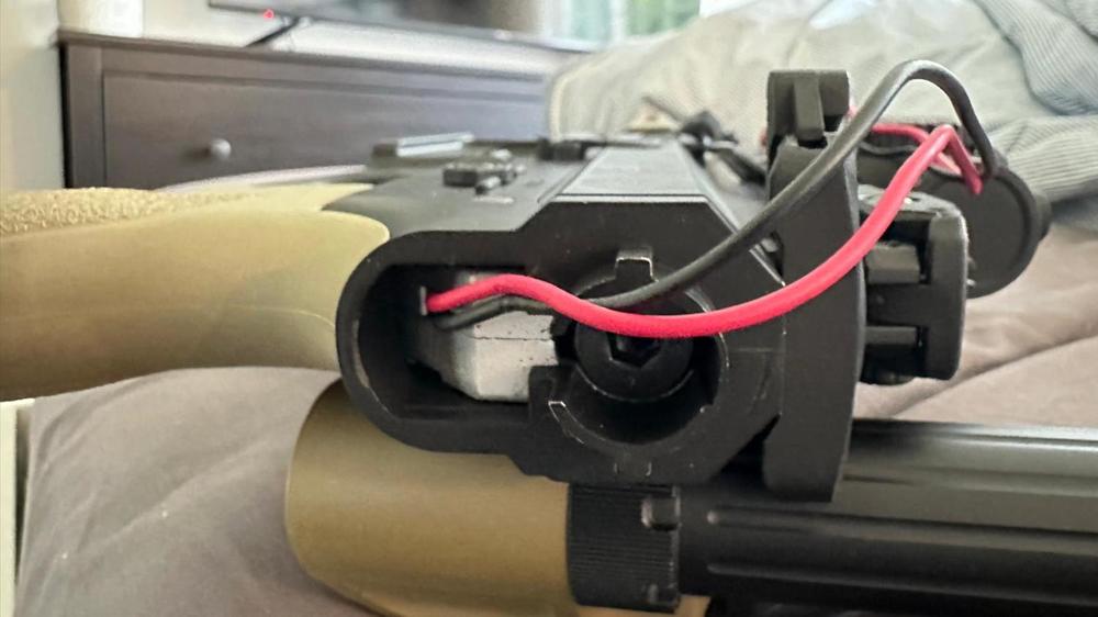

Speedbird_666 Posted June 3, 2024 Share Posted June 3, 2024 (edited) Looks like a fairly standard receiver extension from this disassembly video: You will need a Buffer tube and sling plate. The buffer tube, obviously, to mount your stock. The sling plate to cover the big hole that the wires are sticking out of. If you can find Specna Edge denoted spares - great, should be a drop-in fit. Other brands will likely fit fine, but airsoft 'tolerances' being as they are (i.e lacking thereof), you might find yourself either filing the inside of the buffer tube if too tight on the extension anti-rotation fins, or shimming with bits of a coke can if too loose. I have experienced both. Edited June 3, 2024 by Speedbird_666 JuggyUK 1 Link to comment Share on other sites More sharing options...

Supporters Lozart Posted June 4, 2024 Supporters Share Posted June 4, 2024 14 minutes ago, JuggyUK said: It seems these SA original parts are quite difficult to find online unless my Google skills are not as good as I thought they were. I assume the PTS stock can be just about any brand but the tube and sling plate should preferably be SA. There's plenty of "compatible" parts online, the main issue you'll have is that all the sling plates you'll find are aimed at a more standard style of upper receiver instead of the blocky design of your Specna. Other than that, literally any AEG buffer tube should fit and then the world is your oyster for stocks. Note that PTS is a brand, not a type of stock. Pictures would help here. Rogerborg 1 Link to comment Share on other sites More sharing options...

Supporters Lozart Posted June 4, 2024 Supporters Share Posted June 4, 2024 6 minutes ago, JuggyUK said: Ah, you make a good point. My inexperience shining through there This is the style of stock I am wanting to use Cool, I have one of those and they're decent. It's a PTS EPS (Enhanced Polymer Stock). You'll want a bog standard AEG tube for that: https://www.patrolbase.co.uk/big-dragon-receiver-extension-m4-buffer-tube Sling plate wise, this might work https://www.fire-support.co.uk/product/metal-asap-sling-plate-for-aeg-m4 depends if/how you want to attach a sling. If you literally just want a plate to cover the hole https://www.davescustomairsoft.co.uk/jg-m4-aeg-stock-plate Link to comment Share on other sites More sharing options...
