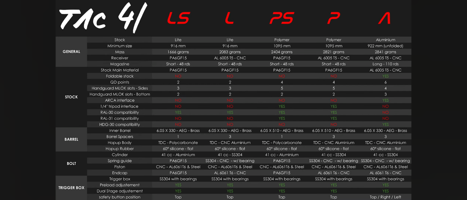

Speedy Sloth Posted May 17, 2024 Posted May 17, 2024 Here's a full image from silverback breaking down the material used for each rifle part and various other specs. The LS does appear to be good value. A guy on YouTube has done tests at 4j+ and it holds up without issue so far. Rogerborg 1
ASP383 Posted May 27, 2024 Posted May 27, 2024 I'll be picking up the Lite as soon as my local shop has it in. Had thought about the Lite Sport due to total budget constraints and I'm sure Silverback wouldn't risk tainting their brand or model reputation with sub parr pasts on either the LS or PS, however, that said, I'll be buying the Lite, as other than the stock and shorter inner/outer barrel, the rest is sae as the established and proven P and A variants, despite it eating more into my total budget, so for now, I'll be using a spare scope and mounts from my air rifles.
