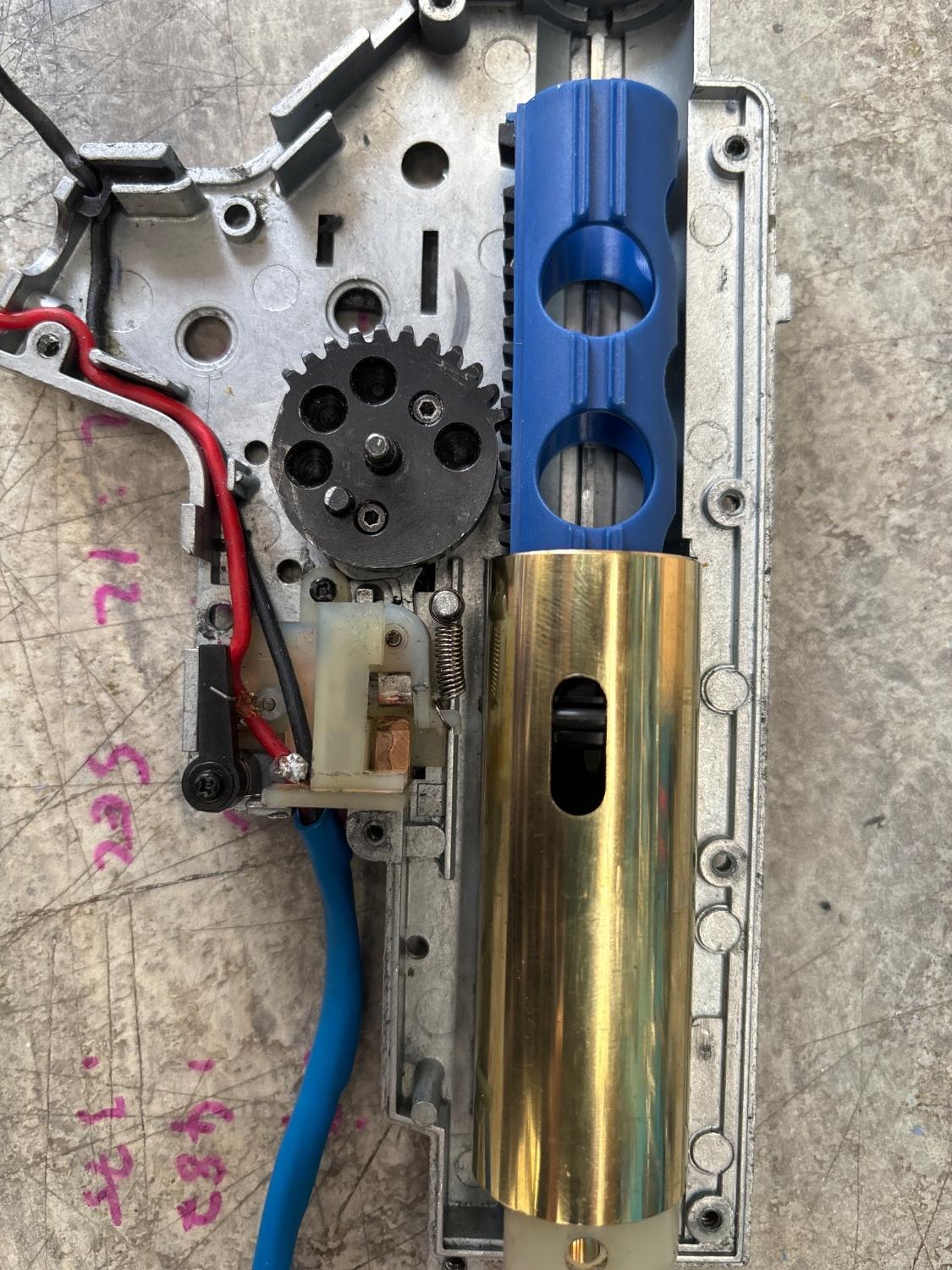

Now GBBR weather is here I am fettling my franken TM&C M733.
I was running 18:1 gears (2 from pick up / 2 from release) with Warhead 35k and 7.4v or 9.9v. Was snappy but a bit noisy. M110 spring giving 1.0J on 0.28g
Noise was probably due to the pad on the cylinder head being pounded into submission as it was the OG TM one and probably old enough to vote! Plus the nozzle was lose and wobbly contributing to midcap syndrome.
New SHS cylinder head on its way, POM piston head and some SHS 13:1 gears to fit. The cylinder is 3/4 ported and probably has a ~36mm air stroke. This is probably ok for the 300mm barrel and 0.28g BBs but might be slightly under according to some?
By dry fitting it with an old sacrificial gear and cycling it looks like -4 on pick up -1 on release is what is needed to stop over travel on the piston….this seems rather extreme!
I was going to start at -2 pick up as gears will be cycling faster and I don’t want tappet timing issues!
What are peoples thoughts? Any experience with this?image.thumb.jpg.fa402bc090b3ee4f62b90dcda977dc52.jpg

You actually don't need short stroking, the "over travel" actually increases your FPS because it accelerates the piston before it goes into the compression zone as opposed to accelerates from within the compression zone, so the overall compression happens faster i.e. there is actually gain in air pressure from the "pre-travel"
Also try putting on the tappet delayer chip on the sector gear to see if it improves feeding, if there is any feeding issues
"Over travel" is a good thing, not a bad thing. I have no clue why people try to avoid it. That extra space for your piston to accelerate increases your FPS efficiency by a significant amount (by increasing air pressure), allowing you to use a weaker spring and have an all-round better time.
Heck, if you're not having PME issues there's no reason to short-stroke either.
Yes, the whole point of having a ported cylinder is to allow the piston to accelerate before beginning the compression phase.
(Short stroking may be more useful with pistols)

Ended up short stroking to a) drop power and b) speed up cycle time.
Seems my M110 spring was actually a M115 so 3 from pick up / 1 from release to get down to 285fps on a 0.28g which seems best performance from testing. 0.25g were a bit light, 0.32g needed lots of hop and dropped a load of speed.

From a physics point of view, even if the piston is not compressing air its still receiving the energy from the spring which it will then transfer to a smaller amount of air depending on the porting of course raising the air pressure.
The speed of compression is higher which creates higher pressures which is more force on the bb even if the energy in the spring and therefore the air is the same.
If you don't need the air volume you don't need a full cylinder but that's not a reason to short stroke. If you only compress the spring by 60% of its usual level that's 60% of its normal energy and if you don't need the energy, then why not just use a weaker spring?
Physics is physics even if it's airsoft.
I reduced my spring rate to get my fps down, which raised the rps of course. 20rps shouldn't cause any issues in normal guns.
Ok, but if you don’t need the air volume why waste time and battery energy pulling the piston all the way back for every shot?
Its not wasted energy, the same air is being compressed but faster and because the bb moves as soon as the pressure is enough to move it, a faster build up of pressure means the pressure is higher earlier as the bb moves along the barrel and why you need a stronger spring to compensate for the loss of spring travel if you compress it less, to maintain the fps
If you choose to have a shorter travel for the piston you must put the similar energy in to get similar energy energy out, but since you are increasing the load you will need more current and so the electrical losses are higher. The mechanical stresses are higher also.
If you are compressing more air than the gun can use it is wasting energy, which is why cylinders are ported to match the barrel length (volume). Since air leaks out from various places a heavier BB will need more air because the time the leaks are happening are longer as the BB needs more time to exit the barrel.
So far as time is concerned, if you get 20rps short stroked on a stronger spring or 20rps on a normal stroke and weaker spring, there no loss of cycle time or wasted time compressing the spring.
If you put a certain amount of energy into a spring over time and then the same energy in a shorter time, there is no time wasted if the energy gets used.
People will short stroke to avoid PME, where the spring doesn't push the cylinder back into position before the gear comes around for the next cycle, but this is something that happens past 25rps and would initially be compensated with a stronger spring to get the piston back sooner perhaps in combination with short stroking to keep the fps under control, or various mixtures of the 2.
It's worth bearing in mind that you don't get something for nothing, if you have more RPS you will use more energy than lower RPS in the same time however you do it. Electrically  you want the least current to minimise the losses and mechanically optimise the energy use needed to get your outcome. Compressing a stronger spring is less efficient than a weaker one in the same time for example, but efficiency is not always the goal.
If you want to have a really high ROF you'll need to sacrifice electrical efficiency and mechanical efficiency to get closer to your goal. Motors will work hard to compress the spring, the gears will have more friction because the pressures are higher on the teeth, and all the insides will experience higher forces making wear higher, damage more likely and timing of the bits that care about timing more important and less forgiving.
I should add, the amount of “cycle time reduction” you get from SSing is functionally ineffective, since you could just use a weaker spring and achieve the same faster cycle.
The only time I think it’s useful to SS (period) is to use a very stiff spring at high RPS while keeping the FPS down. This allows for low FPS and high RPS with no PME. And by high RPS, I mean 35-40 RPS SSGs.
