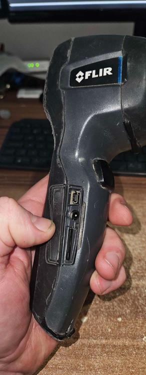

Am,I right in thinking if you get the polarity wrong on a charger you can blow the circuit board of the device you're trying to charge?
Reason being, I have an old FLiR i7 thermal camera that the boy and I were going to use on a game day, so we did a battery test.  Happy to discover that despite it'd age, there was a good 5 hours battery life.
I then had to lend it to a customer (long story) who tried to charge it using an adapter he had at home that was the same voltage but it turns out unknown polarity).
When I got it back there was about 5 minutes battery life left, and when I plugged it in with my charger it wouldn't take any juice.
So I know the battery was/is good, so he's either fried something on the camera or my charger has spontaneously shat itself  (my multimeter is too chunky to get inside the plug to measure the angry pixies).  Possibly a blown diode?
Tah in advance!

If there's reverse polarity it would likely be a series diode, it's a small load and it shouldn't fail even if the polarity was reversed.
Does it show it's charging?
The battery comes out on those doesn't it?

When its plug in the charging LEDs stay off.  Officially the batteries are not user serviceable, however, I found a place still selling the camera with a spare battery as an accessory.  I suspect it's easy enough to change the battery if you can open the case without damaging it.  I have ordered a new charging brick for it as well as some needle probes for the multimeter if only to eliminate that side of things.

Most circuits have polarity protection so the board should be fine.
As Roger said, if the battery charge drops below a certain point an intelligent charger won't recognise it.
I have recovered a couple of very low bats by setting the charger (B6AC) to NiMh mode and charging for 2 mins.  This pumps in enough charge for the intelligent charger to recognise it.
Probably a good idea to change the battery anyway.  Even if it shows a charge it probably won't last long under load when actually being used.

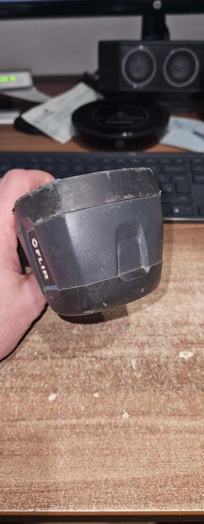

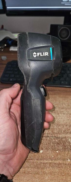

Not on this model:
Hunting for my spudgers right now.
30 minutes ago, Sewdhull said:
The charging area unclips from the top does it not
Ah - not the top - but the back of the handle....  Now don't I feel like a plum LOL.
