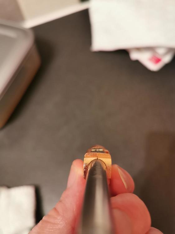

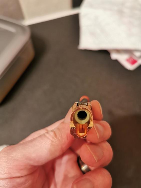

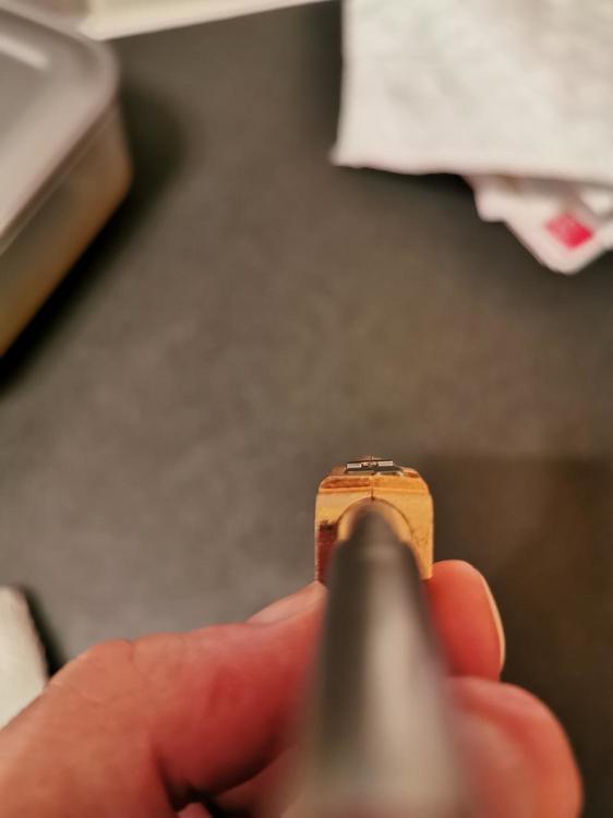

Took delivery of a pre assembled 84mm barrel, bucking & hop up chamber set today, but I notice that the top of the chamber isn't very uniform.
The hop arm is applying pressure at an angle, not sure if I've received one that's not been made incorrectly, or if this just normal for a Maple Leaf hop chamber.
Full hop applied pictures.
No hop applied
I'd give that a jiggle.  Airsoft is not exactly building the space shuttle, but you want you r hop straight.
Looks like standard pistol hop tilt to me, standard as in a common design flaw of that style of arm you'll see on many pistol hops.
You can bend the arm a little to square it off but be very careful as it's very easy to go a little too far and have it snap.
