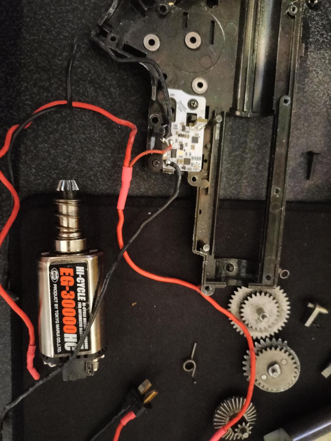

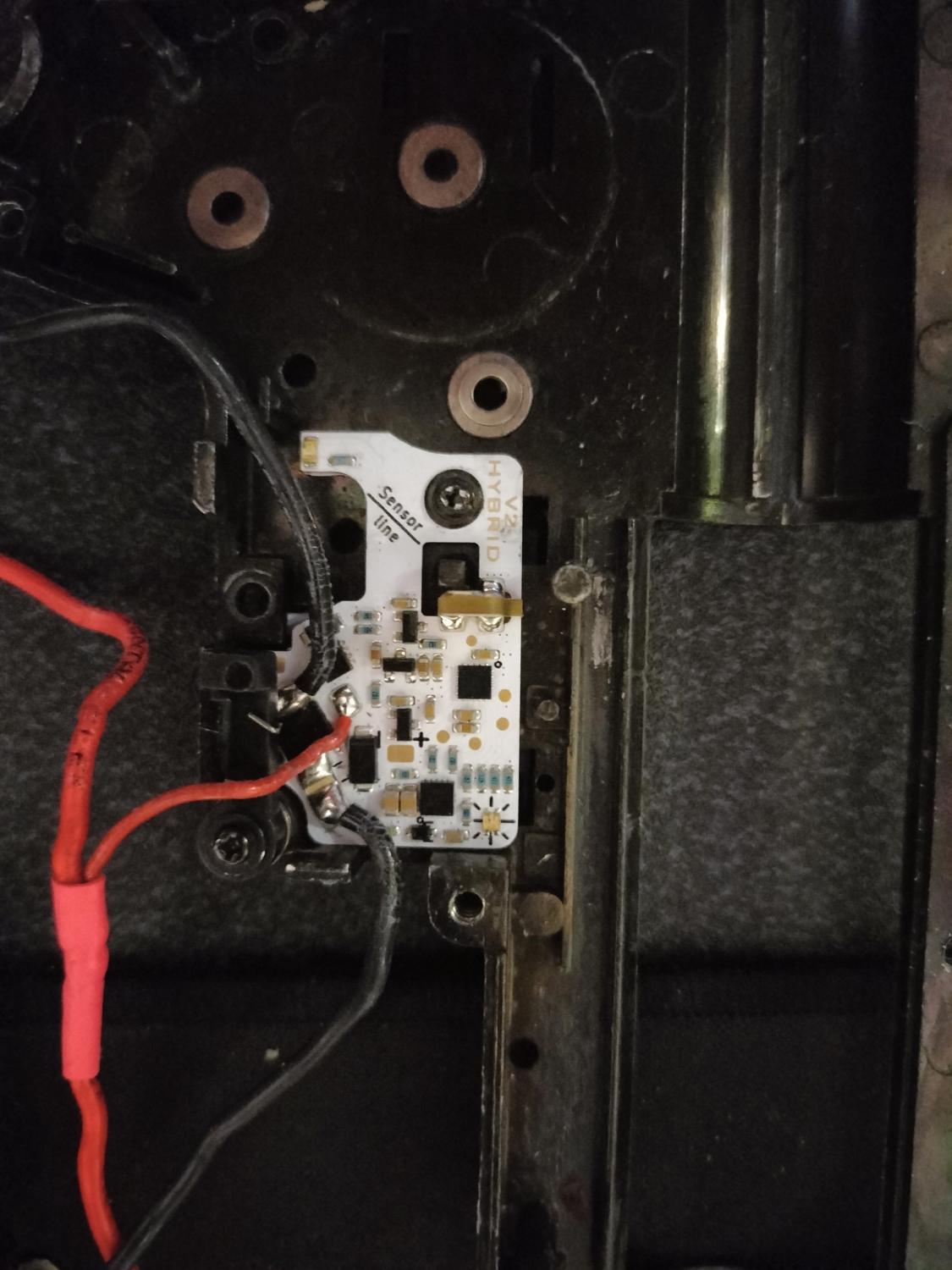

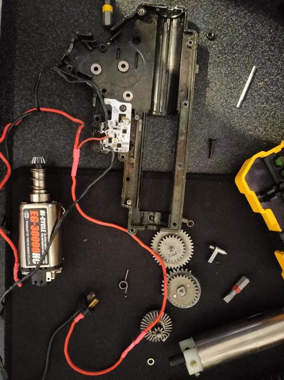

Thanks for your replies guys. I'll post a couple images of the innards before I test the motor, that'll probably be better than me trying to explain whats in there. I attached em to the post.

I can see now the Perun mosfet inside has a fuse built-in (I'm new to exploring the innards obviously, I'm at that point I wish I'd just gotten a professional instead of trying to do it after watching a few youtube vids).
I'm reluctant to pull the motor out of my backup AEG right now incase I bugger that up too and have nothing to play with this week so I'll try that paperclip test, if I can find one that is. Either way the gun will be down for the count till payday I'm thinking.

It's possible the actual MOSFET chip is blown, but usually that makes the motor spin whenever the battery is connected, not only upon trigger pull.

I would guess the free spin of the motor must have overloaded some part of the MOSFET board.
If its the MOSFET then it should be relatively easy to replace with a basic one.

Okay so I tested the motor on the other aeg wiring and it span fine.
Had a look at the mosfets manual and the status led had no indication of an electrical issue.
