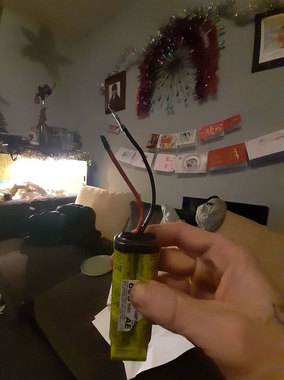

I'm new to the airsoft world and have been given a steyr aug airsoft rifle. I haven't a clue what to do and how to go about it so please would somebody be able to help me out I'd appreciate it soo much
It is not a question of could it be fixed, its a question of should it be.  Spend some money and get a decent 7.4 Lipo and a good balance charger
It's a big battery (physically) but it's only 600 mah, which is quite small.

Nimah which is what you have there, they're big, old and less powerful (an 8.4 nimah is weaker than a 7.4 lipo). They are what used to be popular over 10 years ago.....times have moved on.

Fixing your current battery is like fixing a knackered old car that won't go more than 10 miles even when fixed.
I'd recommend a new battery, probably a lipo.

You could strip the wires back - one at a time, and being very careful not to let them touch - and wire them into a mini-Tamiya female connector: https://www.ebay.co.uk/itm/230965619320
However, that's assuming that you have a charger that will charge that nicad, and that it will still hold a charge.  It wouldn't really be usable on a game day, I'd suggest doing this only if you want to check if the gun still works.
