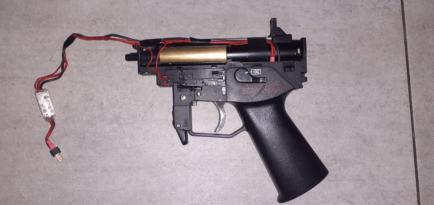

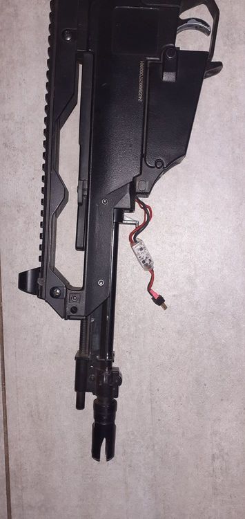

Hi Paul. I have two G36, in both installed AB++. Mosfets I left in battery department. AB ++ has long wires and not cause any problems for triger responds. I'm happy with this setup, and all my batteries have T connectors (deans). Later on I can add pictures if you need.
That's great. Many thanks. I would appreciate  pics and i reckon rewireing/replacing connections with Deans is the answer.

Snap.  There's not a lot of room in there, so I run the mosfet side-by-side with the battery up front.  I'm using 11.1V 1400mAh batteries with 105mm x 20mm x 16mm dimensions, and Deans.
Picture worth a 1000 words. This is great. Thank you.
Well this week has been frustrating.  I cut the ab++in half, requested to by Jakub at Perun. It appears to be faulty. They're sending me a new one. Jakub runs Perun and found the time to help me out and answer my questions  and fault find. Superb service from Jakub/Perun. Whilst signal getting down signal wire to the ab++ it wouldn't  trigger the motor. Lot of tests later it appears board may be faulty. BTW its wired up just like the v3 gearbox in the pic.
