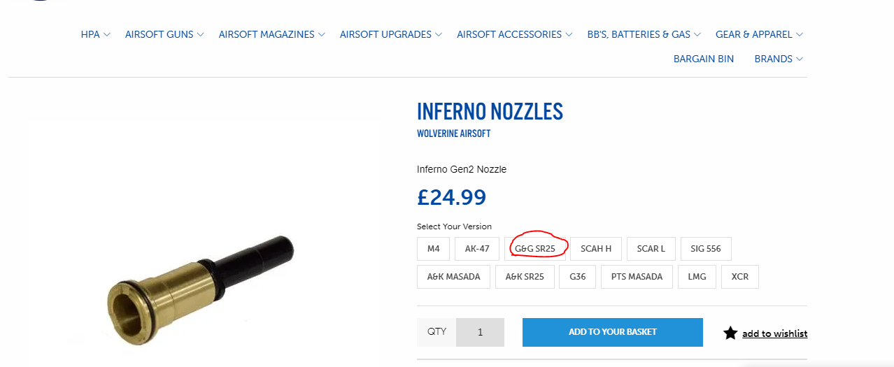

One potential solution that I was going to put in my SR-25 before I decided to try it in AEG mode (to take advantage of the v2.5 gearbox the Cyma has) was to go with a Wolverine Inferno engine. It's an electrical one, so it will require a battery unlike the Kythera, but they do replacement nozzles for the Inferno (which is typically a v2 engine) to use it with some of the weirder guns, including the G&G SR-25
Obviously, HPA builds are pricey, so take the time and find exactly what you want so you waste as little money as possible :D. If I don't like my SR-25 as an AEG (I'm making it as quiet as possible), I'll be going with a Wolverine Inferno with this replacement nozzle in 2023 once I've given the AEG setup a good, thorough trial through the rest of this year (well, the A&K one for me as the Cyma is a clone of it or the G&P)
Edited by Impulse
You bastard! :)  I'm on a different path now. So more research needed, but you have got me leaning towards a Inferno Gen 2 engine. Seems more of a drop in approach with less incompatibility issues, it's compatible with v2 gearboxes which the G&G SR25 is.

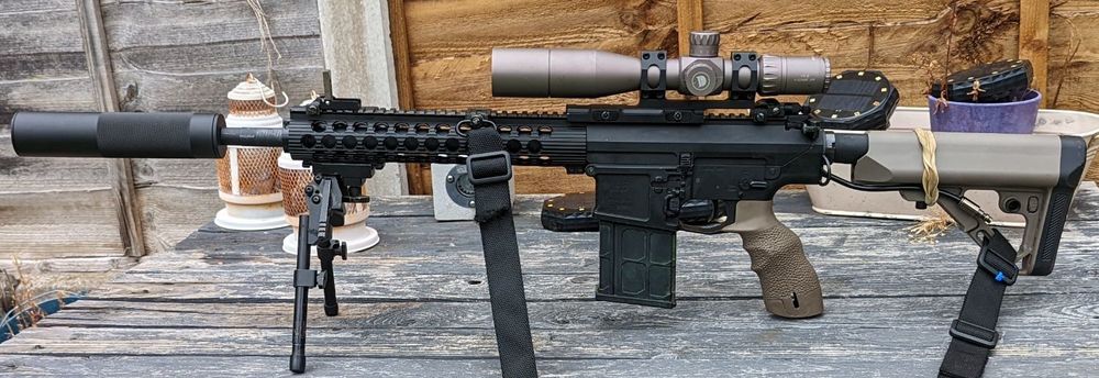

My sr25
Mancraft kit . Maxx hop . Flat hop . Edgi barrel . . Set for .45g
