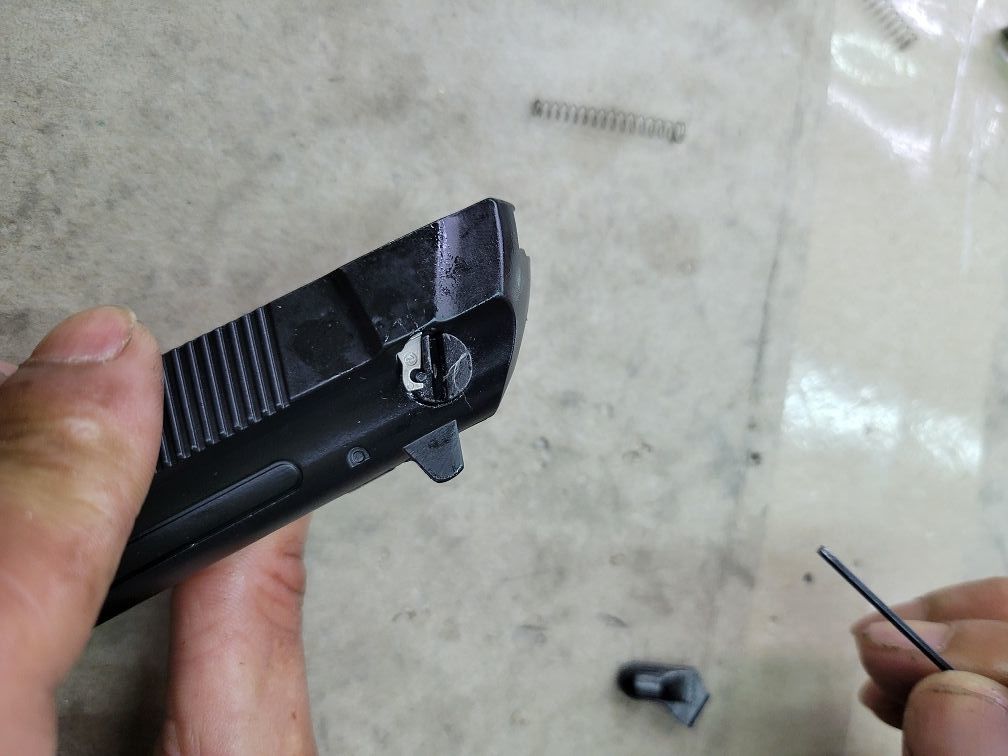

My pistol wont work in full auto and a guy in a store in Aarhus Denmark looked at it today and told me it missed the small part from the picture.
I saw a guy from another forum saying it was similar to what the We M9 is using. Does anyone know where i can get that part, and if it is for the full auto to work correctly?
And can anyone show me exactly where to insert it?

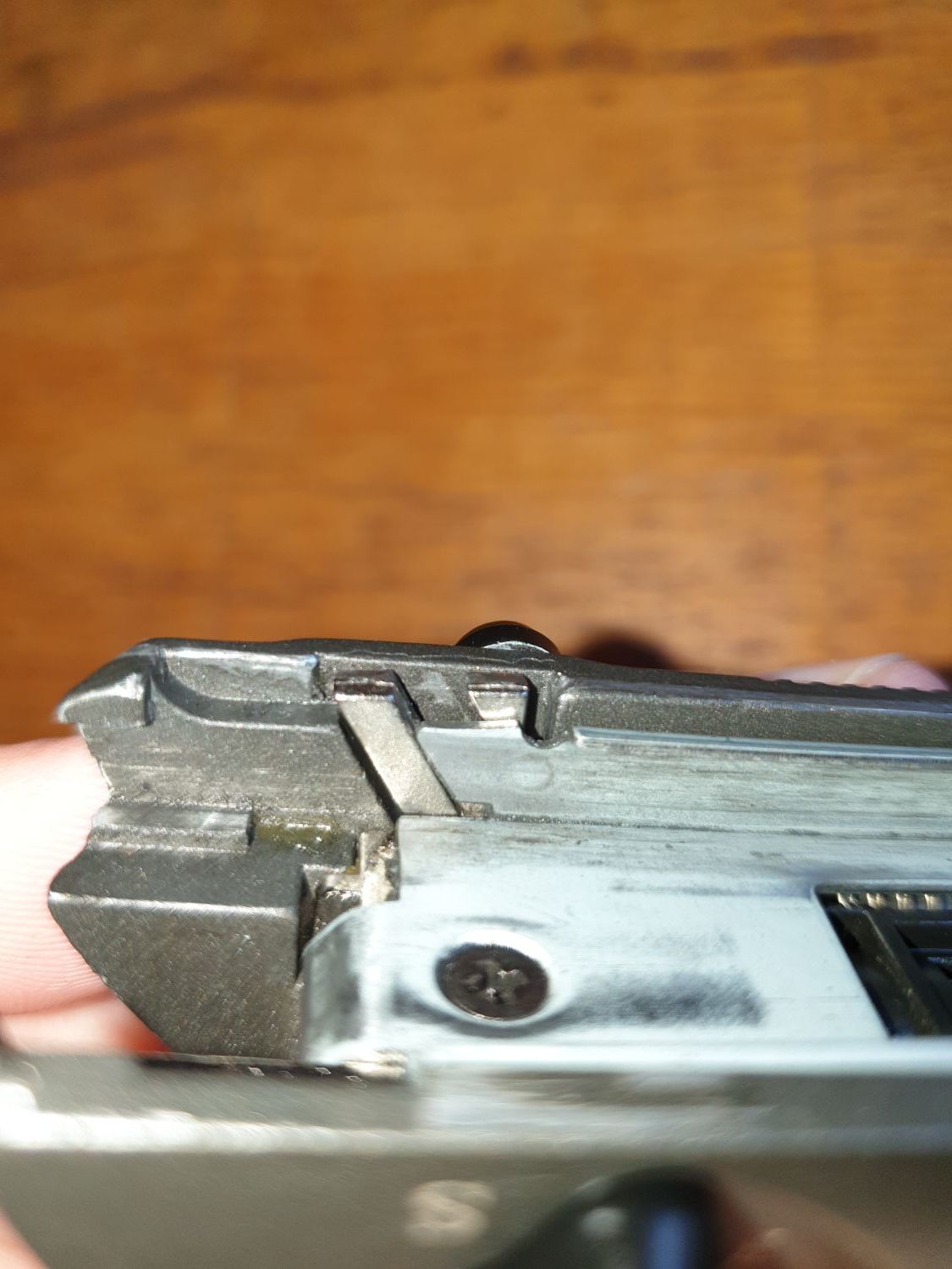

I think it was me that told you about the we m9 part fitting as a remember vaguely someone asking something before.
If i remember correctly it inserts Into the slide by the safety catch. I'll dig my pistol out and look later if I get time

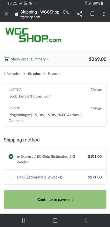

If you can take the small part out without fucking up your gun cam you then measure it and take aome pictures of it, then ill make it myself ? I found it on Ewike or wht the site was called and it said 8$ but then came ahipping and it was suddenly more than 100$ and i was like, no way... That's insane!... If you wanna help me out send it to [email protected].

If anyone can help me to find it cheaper than 100$ let me know

I Made my pistol work again wuhuu
Okay so I got the piece and I inserted it but it didnt work, then some chinese girl send me these videos showing how to insert the #30 piece and when you get it you have to be very careful!!! And you need a small needle to hold a tiny piece, to insert the small piece so it gets pushed down just like in the videos, so i did that and inserted it just like in the video and voila it works again.... Haha it was such a great feeling ??
I hope you guys can use it when your piece get's lost or broken...
