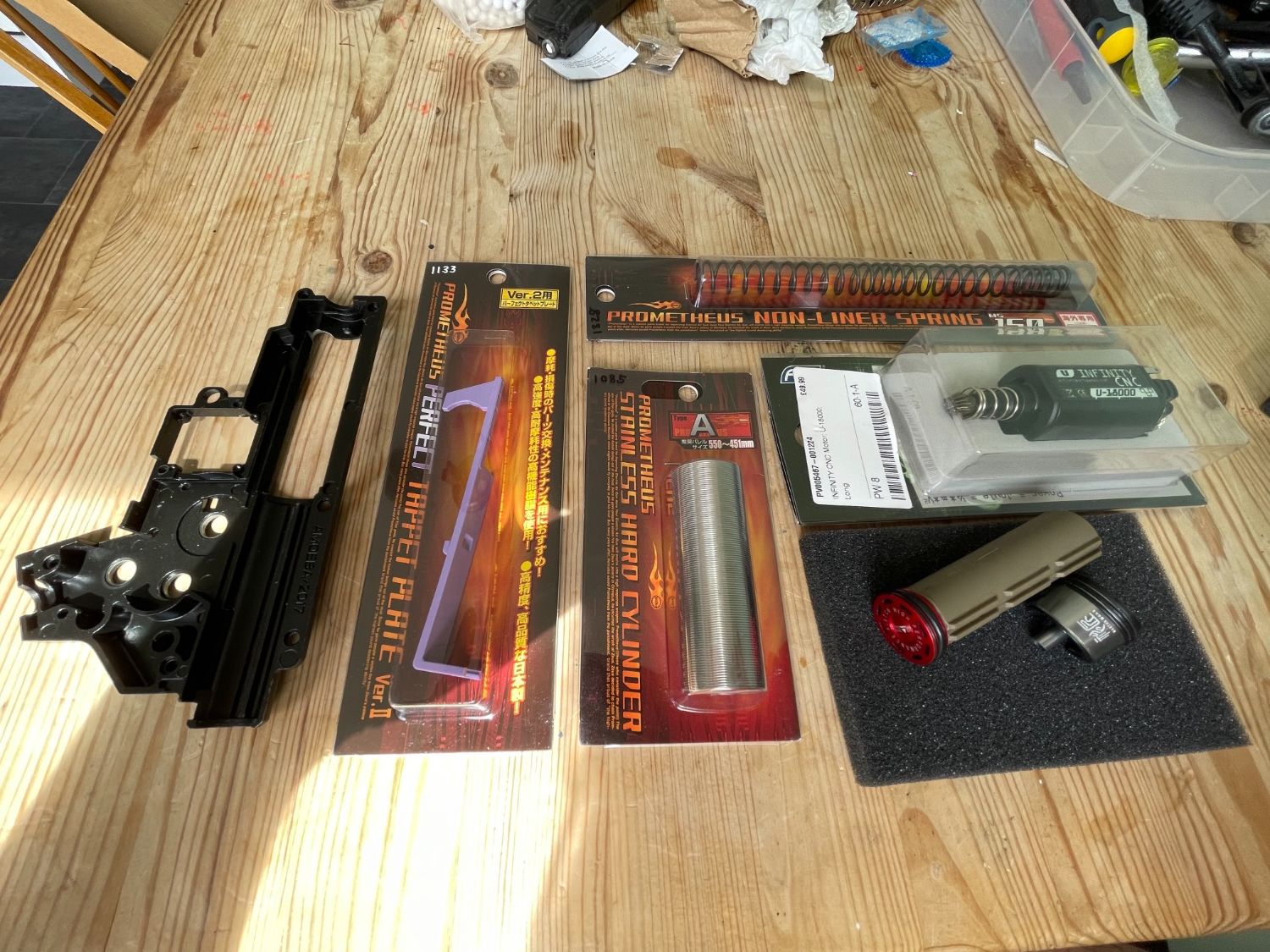

Gray_Ghost_666 Posted July 31, 2021 Author Posted July 31, 2021 The goodies have arrived. The build starts today. Any experienced based advice would be appreciated cheers

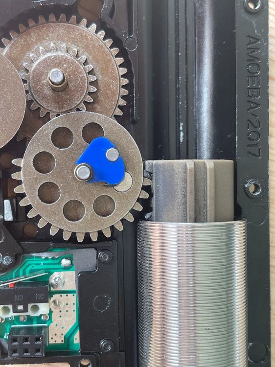

strykerles Posted July 31, 2021 Posted July 31, 2021 May need to flatten down those teeth summore that you ground off. also, why 2 teeth?
Gray_Ghost_666 Posted July 31, 2021 Author Posted July 31, 2021 3 hours ago, strykerles said: May need to flatten down those teeth summore that you ground off. also, why 2 teeth? One was already grounded by manufacturers. When i tested the cycle it was fouling on the the next one up. Obviously will need to tone it down but happy with the results so far FullSizeRender.mov
Supporters Rogerborg Posted July 31, 2021 Supporters Posted July 31, 2021 1 hour ago, Gray_Ghost_666 said: When i tested the cycle it was fouling on the the next one up. I am also baffled. Granted, this is when the least tension is on, but as Oscar Wilde so adroitly noted, to lose one tooth may be regarded as a misfortune; to lose both looks like carelessness. Didn't Luke at Negative just rant about removing two teeth?
strykerles Posted July 31, 2021 Posted July 31, 2021 @Rogerborg he did indeed, shave it, not remove it
