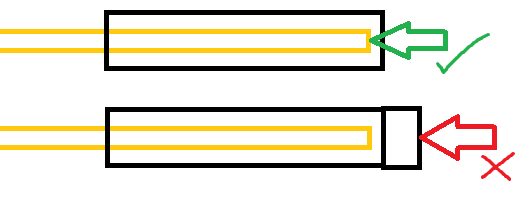

Potentially stupid question to ask before dipping into advice if there is a leak (it'll tend to be from the hop if there is one), are you covering the end of the inner barrel itself rather than the end/whatever device you have at the end of the outer barrel? It's damn near impossible to do this type of compression test if you're not covering directly over the inner barrel, it's seemingly hard to explain what I'm trying to say with words. I can try and throw together a shit example on paint if I'm making zero sense.
Edit:
I went ahead and did my shit paint drawing to try and better illustrate my question.
Yellow is the inner barrel, black is the outer barrel.
If you're currently covering the end/cap of the outer barrel as shown above by the red arrow you'll be losing air out of the inner barrel... hence appearing to be a leak. If you're covering the end of the inner barrel as shown above by the green arrow (I'm assuming requiring the removeal of the end cap) then you're likely leaking fro your hop chamber. It'll vary depending on what bucking you're using, I believe you had a FAST hop you were putting in it? Historically I found Silverback buckings in the FAST hop needed a very small amount of *whispers very quietly* PTFE tape to ensure a seal.

I did the test with the barrel end cap off. You can hear air leaking out of the back of the cylinder. Same thing happens if I take the bolt out and hold my finger over the nozzle.

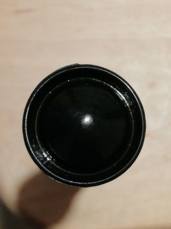

I have noticed this. I don't know how perfectly circular the edge of the piston cup needs to be.

Just looks like a bit of 'flash' from the moulding process, wouldn't be enough to disrupt anything imo... largely because it looks to be on the bottom edge of the piston cup. It's hard to say really, given they're made in batches and seem to iterate on the design/manufacturing of components for each run outside of general advice of what usually works it's difficult to provide much else.

That air seal doesn't look good at all.  Any deformations on any surface which contacts to create the air seal will have an affect. (whether its the seal or the inner surface of the cylinder)
If you have bought the RIF new then contact the retailer regarding this and it should be covered through warranty.
Some people on fb have said it looks OK to them but I'm not convinced as I've definitely seen better.
