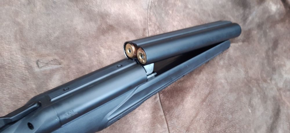

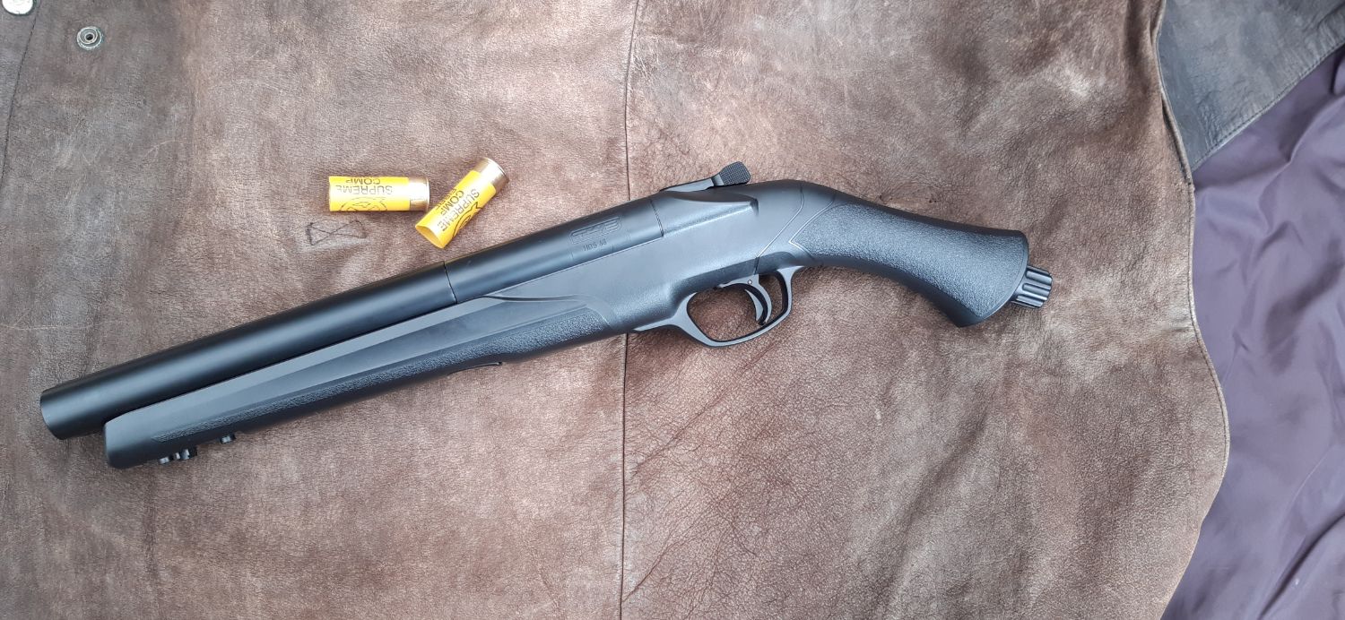

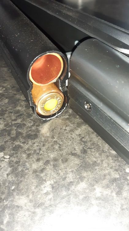

I bought a Umarex T4E. Took 10 minutes to remove the inner barrels, cut down slightly at the breach end, remove the rubber paintball retainers, and add 2.5 inches of 22mm copper pipe in each breach.
Then, 1 minute per shell to make viable.
I use spent 20g shells which I get bags of totally free from a local gunshop. They have to be trimmed and the primers knocked out and a 10mm hole drilled in the rear.
I'm yet to paint it, but the results are that the shells hold 30bbs, have a proper sawn off spread, and are disposable. (Not that I want to lose them but it means I can eject and reload on the fly without worrying about shells at 10 quid a pop).
It works that well I'm going to be buying a second.
The downside is it's not as realistic as the 2 other options but it is well made, like the H8R, and is a genuinely useable shotgun.

You don't need to, as they're now firing bbs down a drainpipe. Aps co2 shells are 18 joules with a solid projectile. If you bought the 1 joule version I think it would be horrendously underpowered. I originally used the shells with just the primer hole, and that was too restrictive.
