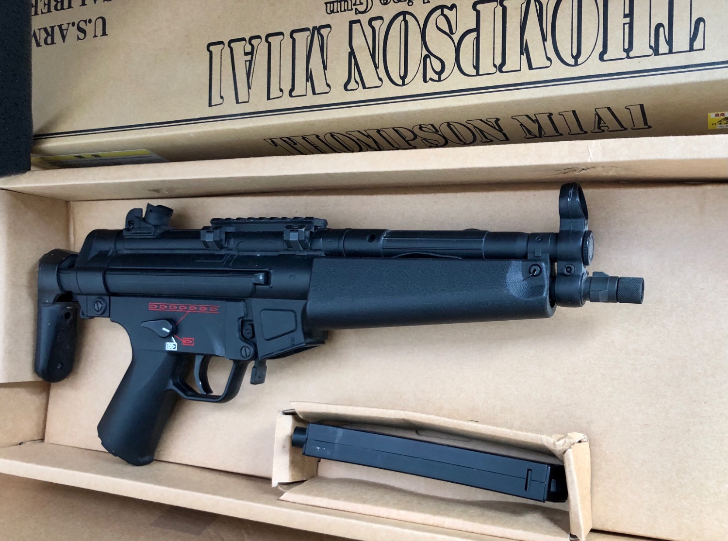

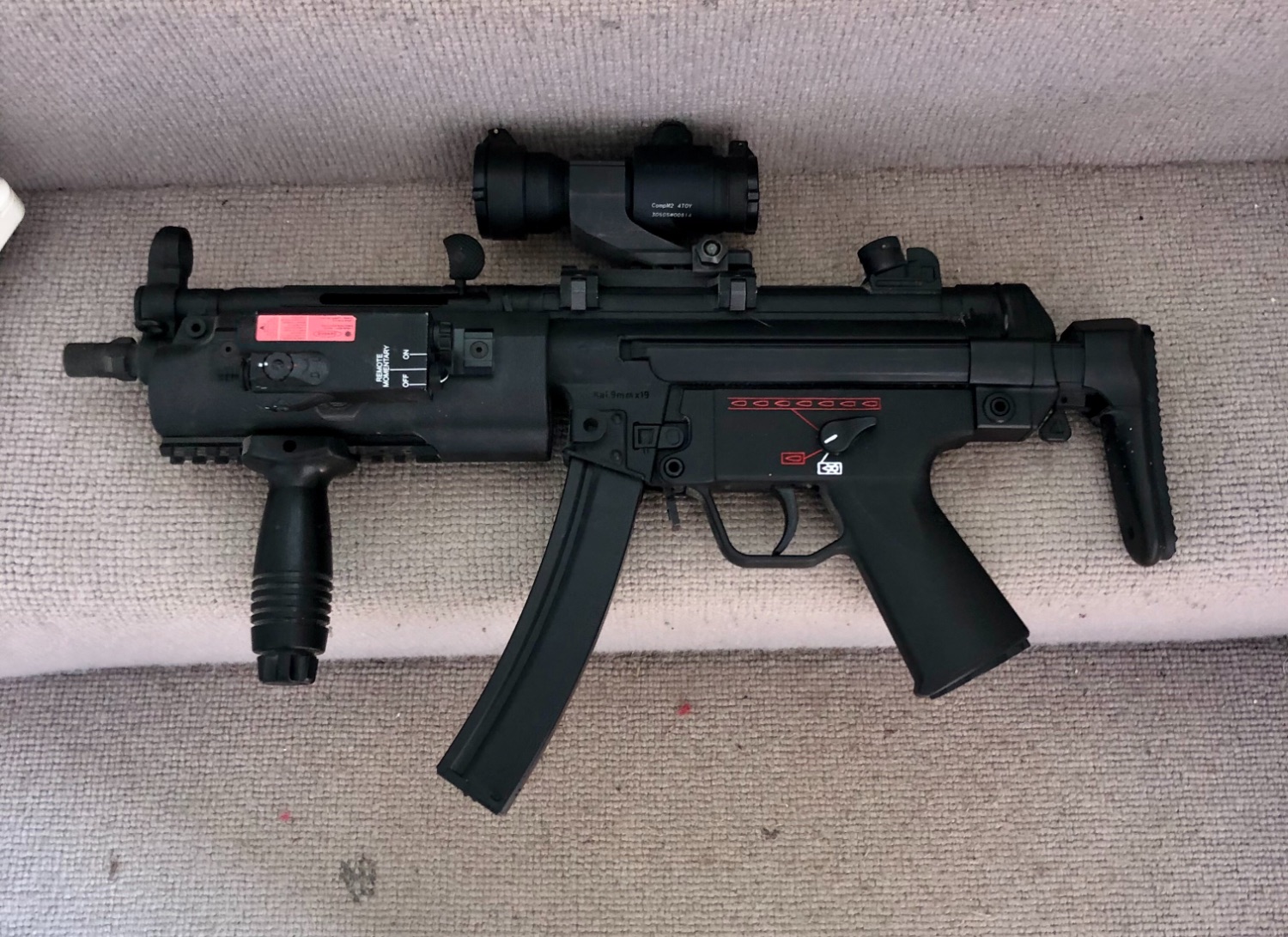

Nothingtoxic Posted May 11, 2021 Posted May 11, 2021 Excuse my ignorance - I’m new to airsoft after buying a job lot of guns as part of a clearance. I have (amongst others) 2 ICS guns. They came with 2 magazines with a winding wheel underneath. If I wind the mag up before inserting it it unwinds when I put it in. If I insert it then wind it up it fires 1 round then unwinds. The same thing happens with both guns and both magazines. Am I doing something wrong or does this indicate a particular issue? Thanks in advance.

EDcase Posted May 13, 2021 Posted May 13, 2021 Sounds like the mechanism is just fubar. You can normally get new ones for around £15-£20 Unfortunately UK shops are low on stock because of the Brexit crap. I think this one is compatible https://www.landwarriorairsoft.com/airsoft-magazines-c3/high-capacity-c51/jing-gong-spare-high-capacity-magazine-for-mp5-aeg-p10517
Supporters Adolf Hamster Posted May 13, 2021 Supporters Posted May 13, 2021 9 hours ago, Nothingtoxic said: Yep, completely full. hmm, only thing i can think beyond it being broken is maybe there's a logjam of bb's in there? emptying and re-filling the hopper should confirm that. otherwise as @EDcase says new mag time perhaps. good opportunity to join the mid-cap master race if you ain't so fond of winding.
BigStew Posted May 13, 2021 Posted May 13, 2021 Spring could be slipping but that would generally mean something broken In the mech. Next stage would be to at least take the mag casing off.
