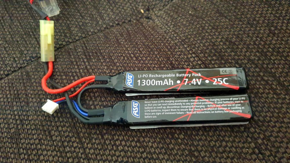

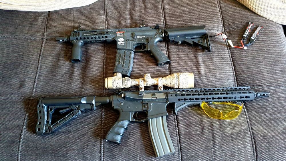

Murray67 Posted April 19, 2021 Posted April 19, 2021 Good day everyone. My son has 2 guns. Both with the same batteries. Both of which appear to have failed after little use. Both weapons have a double pack. ASG li-po 1300mAh. 7.4v 25c. Do I have to buy the exact spec or can this be upgraded. Upgraded by means of more mAh and more v. Thanks guys
Supporters Adolf Hamster Posted April 19, 2021 Supporters Posted April 19, 2021 couple of questions, what do you mean by "little use", and do either of those guns have mosfets in them? reason i ask is a lipo battery will be killed by over-discharging, which in airsoft terms is continuing to try and fire until it just won't cycle. some mosfets have built-in cutoffs that mean you can just fire away and the mosfet will stop the gun from running once the battery has drained. whilst you can get away with running a gun on a lipo with no cutoff, it's really not recommended especially for newer/younger players as in the best case you'll kill the battery (as i suspect might have happened here), worst case burn something. as for higher voltage/capacity there's 2 answers: voltage it depends, the gun will run faster, which isn't bad in and of itself however it might push it fast enough to cause problems depending on the setup, often for a stock gun this isn't too bad but it is something to consider. capacity there's really no drawback to having more, as long as the battery physically fits in the gun (generally more capacity tends towards a physically bigger/more expensive battery)
EDcase Posted April 19, 2021 Posted April 19, 2021 Hi and welcome Murray Those look like decent capacity batteries. What charger have you got? Its better to have two batteries and swap at lunch rather than use one until its completely flat. If not using a battery for several weeks its best to select 'Storage charge' after the game day (if you have an intelligent charger) I would advise to stick with 7.4v and as high mAh as will physically fit in the space. 11.1v will work, and be very snappy, but puts much higher strain on all the components in the gearbox so likely cause a failure more quickly.
Murray67 Posted April 19, 2021 Author Posted April 19, 2021 30 minutes ago, Adolf Hamster said: couple of questions, what do you mean by "little use", and do either of those guns have mosfets in them? reason i ask is a lipo battery will be killed by over-discharging, which in airsoft terms is continuing to try and fire until it just won't cycle. some mosfets have built-in cutoffs that mean you can just fire away and the mosfet will stop the gun from running once the battery has drained. whilst you can get away with running a gun on a lipo with no cutoff, it's really not recommended especially for newer/younger players as in the best case you'll kill the battery (as i suspect might have happened here), worst case burn something. as for higher voltage/capacity there's 2 answers: voltage it depends, the gun will run faster, which isn't bad in and of itself however it might push it fast enough to cause problems depending on the setup, often for a stock gun this isn't too bad but it is something to consider. capacity there's really no drawback to having more, as long as the battery physically fits in the gun (generally more capacity tends towards a physically bigger/more expensive battery) These guns were basically bought for my son but never used outside the garden and have sat for over a year doing nothing. That was because they both stopped working. I have zero knowledge on these guns and have no idea what a mosfit is. Sorry. As for charger. See attached photo. Again, no idea about the setting on it. But last night I put the batteries on charge and 12 hrs later the green lights were still flashing, meaning not charged.

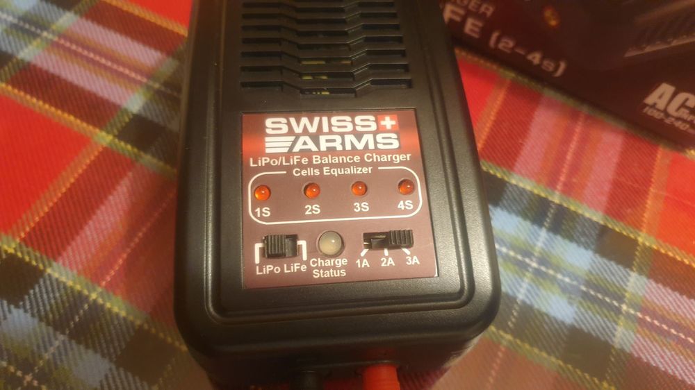

EDcase Posted April 19, 2021 Posted April 19, 2021 Yeah, if they haven't been charged in over a year they're probably dead. There is a possibility to revive them with a NiMh/NiCd charger but must be done carefully to avoid a fire and they may never get to 100% so probably best to get new ones. The charger looks OK but if you want the batteries to last as long as possible it may be worth investing in an intelligent charger. (Do a search for the thread talking about chargers) Hopefully someone can confirm but I think the 'A' setting should be on 1A for batteries below 2000mAh

EDcase Posted April 19, 2021 Posted April 19, 2021 Yeah I meant for optimal charging to prolong the life of the battery. They can be charged at a higher rate but since you're normally preparing things a day in advance I would always go gentle on the batteries.

Supporters Lozart Posted April 20, 2021 Supporters Posted April 20, 2021 7 minutes ago, Murray67 said: So guys, a quick recap. Dont let the battery go totally flat and if you do, dont let it sit flat for weeks? Basically always retain a charge in the battery and it should last. Is that about right? Pretty much. Also - look into getting a balance charger. Something like this would be good https://hobbyking.com/en_us/accuell-s60-ac-charger-uk-plug.html
Murray67 Posted April 20, 2021 Author Posted April 20, 2021 This is what we have. We have 2 of them and TBH there is no instructions with them.
Supporters Lozart Posted April 20, 2021 Supporters Posted April 20, 2021 21 minutes ago, Murray67 said: This is what we have. We have 2 of them and TBH there is no instructions with them. Honestly, if you're planning on keeping the guns for a while and using them get a better charger. The one I linked to is £25ish and it'll help your batteries last longer!
