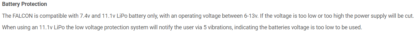

Found this:-
and
I've also read that damage occurs to a LiPo at 2.5v/cell
So.....
Really bad to run a 3cell 11.1v LiPo down to 6 volts where the mosfet cuts out but how the heck are you supposed to feel vibrations from the mosfet with everything else going on?
It appears I shouldn't run an 11.1 down below 9volts. Certainly not to 6v.???
It would appear to be only really safe for 7.4's which don't seem to last.

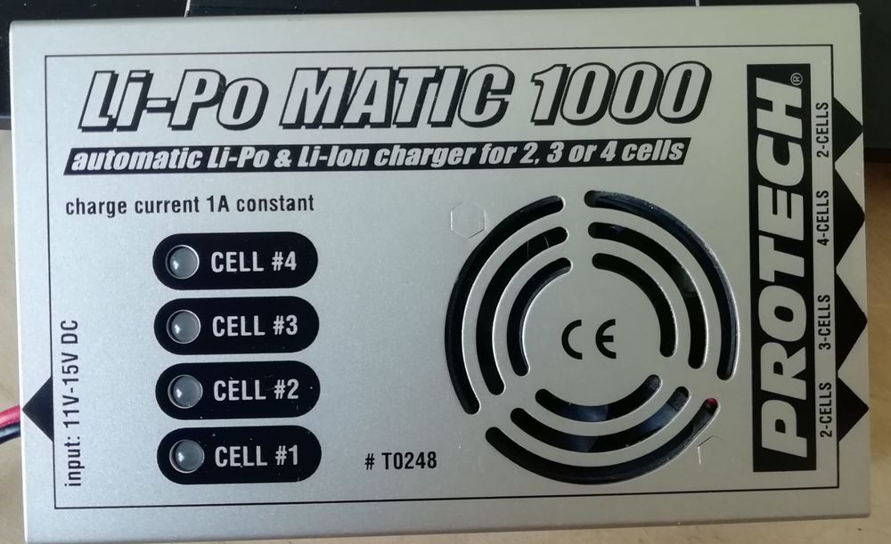

42 minutes ago, ak2m4 said:
What kind of charger are you using?  Do you have one of those small battery voltage checkers?
This. Probably 10 years old but was a decent one at the time for my RC helicopter.
Should I get a newer one?
I've got a multimeter kicking around somewhere. Would that do?
