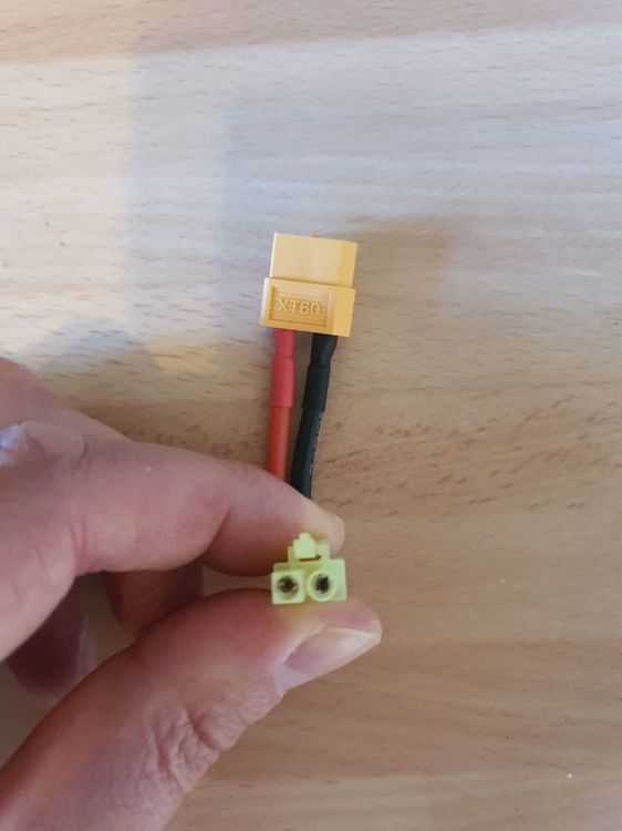

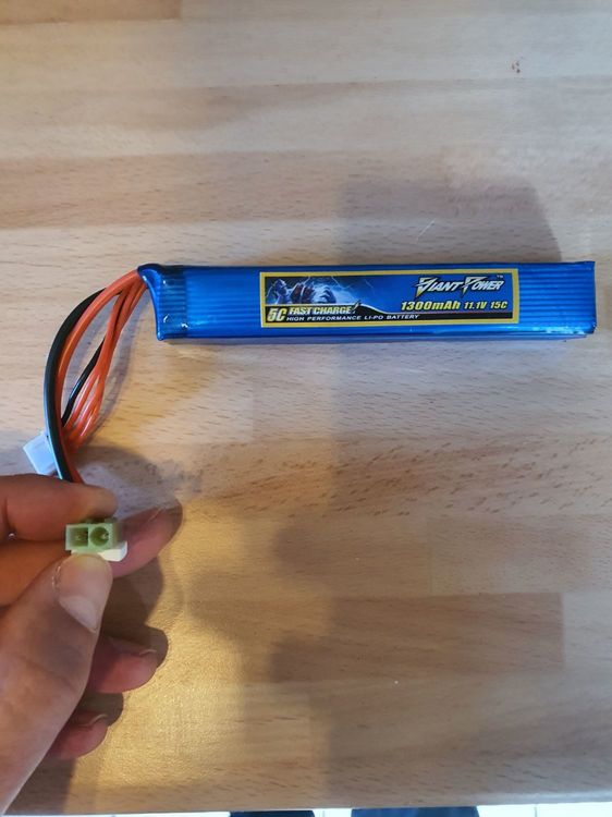

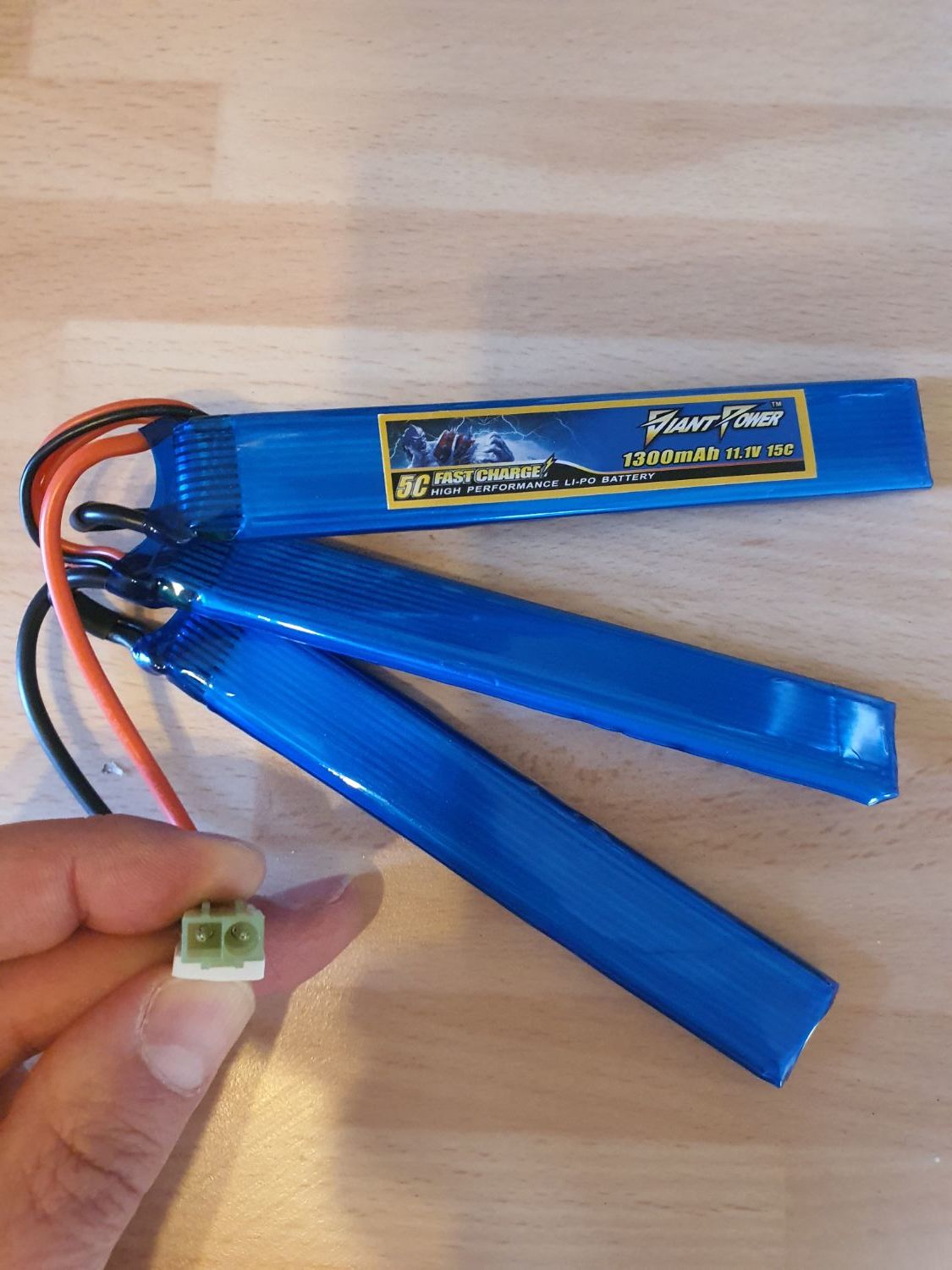

I bought myself an XT60 to mini Tamiya adapter seen in the first image attached, however when I went to connect either of the batteries shown I got a "Reverse Polarity" error and then realised that the live and negative wires didn't not match the configuration of the battery connector wires.
I bought the adapter cable from eBay, is this right? Are there different types of XT60 to Mini Tamiya cables out there?
On the batters the live (red) wire leads to the circle male part of the connector and the negative (black) wire leads to the square male part of the adapter, this is the other way round on the XT60-Mini Tamiya cable.
Airsoft standards are reversed to rc standards so it not uncommon to find adaptors sold favour the rc standard.
The quickest and easiest fix is to pop the pins out of the tamiya connector and swap them over to match your battery.
Having said that I'd also recommend swapping the tamiya connector out completely for either a deans or xt type connector, both are much better connectors.
Further up this very thread I posted a video on how to swap the pins on a mini tamiya using a biro. I also covered the reverse-polarity issue with Airsoft connectors.

Apologies, I totally missed that part of the post! I'd never have thought of using a biro to remove the metal connector from the plastic jacket...fantastic! Thank you
