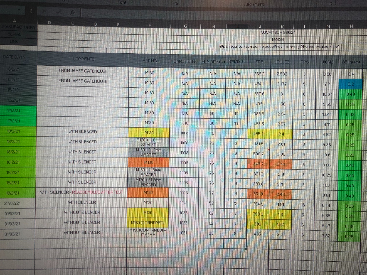

AP77 Posted March 1, 2021 Posted March 1, 2021 Hi all, I recently bought an SSG24 and upon cleaning and a full inspection, I installed an M150 spring to get just below 500fps. The seal is excellent and the piston is not worn however, the chronograph only get just below 400fps (1.82Joules) with 0.25 BBs when the Novritsch website's chart read I should have circa 480fps (2.15joules) with 0.2 BBs. I realise from 0.25 to 0.2 would imply a higher fps but I doubt it would make for the almost 20% inscrease (?). I checked the obvious and the barrel is not scratched and degreased / cleaned, so is the nozzle, brand new HopUp from Novritsch etc. Is someone has any idea where I missed the obvious ?

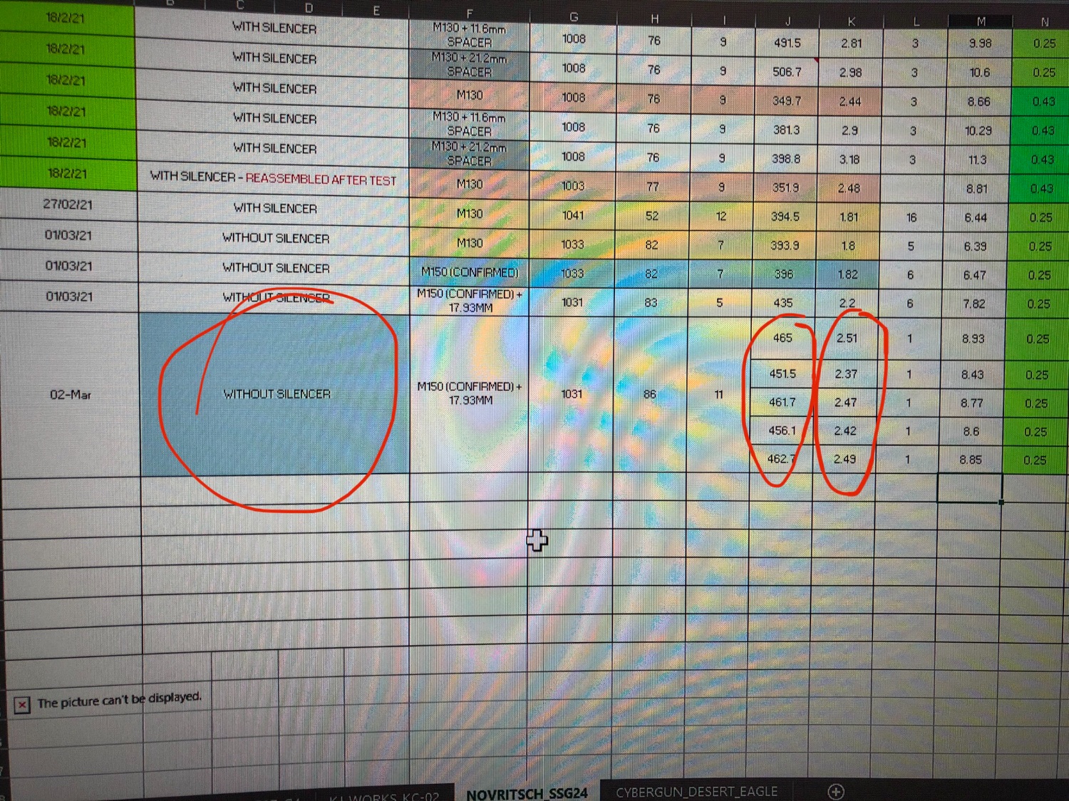

AP77 Posted March 2, 2021 Author Posted March 2, 2021 27 minutes ago, Shaydee said: It's more like 507 FPS on 0.2s unless I'm misreading something. So dependent on OP's location that would be over the majority of British site limits by a small margin. 2.32 joules is the old 500fps on 0.2g limit. I'll echo the sentiment with regards to recording the shot to shot consistency, this is the most important thing for a bolty. @AP77 spreadsheet screengrab you've posted only lists one number per line - is this an average or just one reading? This is an average. I did a shot per shot reading this morning (attached) and If I am not mistaking I am well above the 2.32joules thus will have to remove some of the spacers on the spring..
Shaydee Posted March 2, 2021 Posted March 2, 2021 Should be able to tighten that consistency up a bit as well, a 15 fps spread isn't the worst I've seen but I'd expect more like 3-5 if everything is tip top. Also again, run the BB weight you intend to use through the chrono and measure the energy on that not on .25s . . . unless for some reason you're going to use .25?
Supporters Adolf Hamster Posted March 2, 2021 Supporters Posted March 2, 2021 also worth noting that fps variation is gonna seem worse with lighter ammo. 15fps on a bolty doesn't sound right to me, i'd be wanting to see single digits on an aeg let alone something that's meant to be even higher precision.
Skara Posted March 2, 2021 Posted March 2, 2021 1 hour ago, AP77 said: Thanks Skara, would this help if I make the piston lighter ...? In my testing I have found that a lighter piston actually increases Joule Creep, at least it does on my build. A heavier piston only killed the energy output with 0.2s but the Joules on 0.4s stayed the same Either way, 15 fps is roughly 3 m/s deviation, which per se isn't too bad but as a sniper you want all the consistency you can get to have repeatable shots. Check each individual "step" in air seal: Piston head to cylinder; Cylinder to Cylinder head; Nozzle (on top of the cylinder head) to hop rubber lips; Hop rubber to barrel. The first two are easy to check, with just the cylinder in the receiver (so everything else, stock, barrel removed) cock it, press your finger on the nozzle and pull the trigger, the piston head (where the o-ring sits) should travel just past the port and stop, being held back by the compressed air inside the "closed" portion of the cylinder. If it doesn't, there is a possible air leak around the piston head o-ring or the cylinder head. Use proper lubricant and not PTFE, please. Nozzle to hop rubber lips: gun upside down, place a piece of tissue paper where the bb feed hole is and fire a shot, if it flies away it means that there's air escaping from the rubber's feed lips. Either replace the hop rubber or wrap (and then superglue) a small portion of heat shrink around the nozzle end. Hop rubber to barrel: hardest to test, it's always good to wrap PTFE where the rubber overlaps the barrel. Some people wrap until the bottom channel of the barrel is covered (so say 3-4 centimetres from the end of the rubber). The hop chamber will compress the PTFE enhancing the seal, don't overdo it or you won't be able to close the chamber anymore. Some hop rubbers, like the Maple Leaf MR-Hop, are known for not giving good air seal (GBB/VSR version only, the AEG version is super air tight), but in my experience with them the leak is so consistent that it becomes irrelevant. Once you sort these things out the fps deviation will drop considerably and test the seal with the gun fully assembled (by doing test n.1 but with your finger over the inner barrel this time). I've read of people getting less than 5 fps in deviation in some cases and it's pretty impressive tbf, given the shit tolerances of our toys..

AP77 Posted March 2, 2021 Author Posted March 2, 2021 10 hours ago, Shaydee said: Should be able to tighten that consistency up a bit as well, a 15 fps spread isn't the worst I've seen but I'd expect more like 3-5 if everything is tip top. Also again, run the BB weight you intend to use through the chrono and measure the energy on that not on .25s . . . unless for some reason you're going to use .25? it was only to get closer to what I thought would be the site testing with the .2 BBs 10 hours ago, Skara said: In my testing I have found that a lighter piston actually increases Joule Creep, at least it does on my build. A heavier piston only killed the energy output with 0.2s but the Joules on 0.4s stayed the same Either way, 15 fps is roughly 3 m/s deviation, which per se isn't too bad but as a sniper you want all the consistency you can get to have repeatable shots. Check each individual "step" in air seal: Piston head to cylinder; Cylinder to Cylinder head; Nozzle (on top of the cylinder head) to hop rubber lips; Hop rubber to barrel. The first two are easy to check, with just the cylinder in the receiver (so everything else, stock, barrel removed) cock it, press your finger on the nozzle and pull the trigger, the piston head (where the o-ring sits) should travel just past the port and stop, being held back by the compressed air inside the "closed" portion of the cylinder. If it doesn't, there is a possible air leak around the piston head o-ring or the cylinder head. Use proper lubricant and not PTFE, please. Nozzle to hop rubber lips: gun upside down, place a piece of tissue paper where the bb feed hole is and fire a shot, if it flies away it means that there's air escaping from the rubber's feed lips. Either replace the hop rubber or wrap (and then superglue) a small portion of heat shrink around the nozzle end. Hop rubber to barrel: hardest to test, it's always good to wrap PTFE where the rubber overlaps the barrel. Some people wrap until the bottom channel of the barrel is covered (so say 3-4 centimetres from the end of the rubber). The hop chamber will compress the PTFE enhancing the seal, don't overdo it or you won't be able to close the chamber anymore. Some hop rubbers, like the Maple Leaf MR-Hop, are known for not giving good air seal (GBB/VSR version only, the AEG version is super air tight), but in my experience with them the leak is so consistent that it becomes irrelevant. Once you sort these things out the fps deviation will drop considerably and test the seal with the gun fully assembled (by doing test n.1 but with your finger over the inner barrel this time). I've read of people getting less than 5 fps in deviation in some cases and it's pretty impressive tbf, given the shit tolerances of our toys.. Thanks for the tips : Piston head to cylinder test : the piston was held by the pressure very well / did not travel all the way down and even after 15s there is a considerable amount of pressure left in the cylinder = PASSNozzle to hop rubber lips test : the tissue did not moved at all = PASS After the above I did a shot-to-shot comparison with 0.43 BBs and found 5.8fps difference over 5 shots which seems not bad considering the comments above (?) therefore I did not do the other tests, although I did fire with a finger at the end of the inner barrel and had the same result as the first test above (the cylinder held pressure) thus a PASS ! Many thanks to all of you for your help with this, this is greatly appreciated
