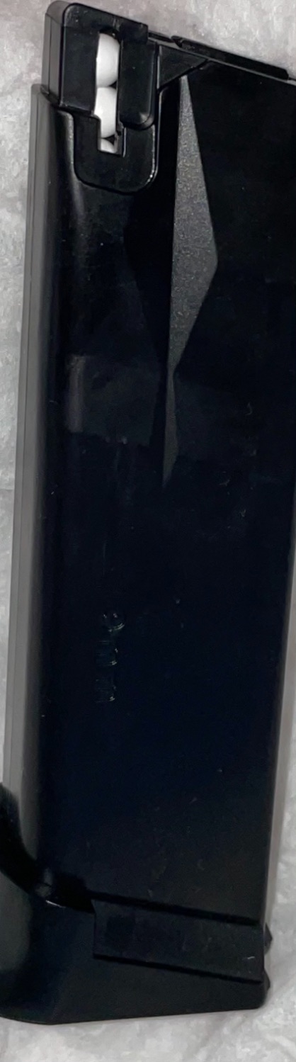

Good evening everyone, I bought a KWC Sig Sauer SP2022 Spring Pistol as a Plan-B-Gun for indoor shooting at home, one week ago. Today it arrived and I tried it out. I saw many YouTube Videos about this pistol and everyone was able to pull the slide back so the Hammer was up and they were able to shoot bbs. When I dryfired I was only able to shoot when I put the hammer up with my hands. Of course I then wanted to shoot some Bbs, after a bit of help from a Facebookfriend I was able to fill the Mag with BBs and when I tried to pull the slide back it didn’t put the hammer up and was harder than without the BBs, I’ve put the Hammer up with my Hand again but it dryfired. I checked the Magazine and all my Shot caused was, that the Bb on top in the Magazine was loose and fell on the ground after taking the Magazine out. Does anyone have this Pistol and can help me to fix it? Do I have to do something with it (except from filling the Mag and setting on „Fire“ which I’ve of course done) before it will shoot? Would someone even just for the sake of making sure I’ve put the Bbs in correctly guide me through the process? That’s how it is loaded.

but one thought did pop into my head- did you fill the magazine completely with bb's? might be if it's really stuffed then it's having trouble feeding.
easy check is to pull a couple of bb's out of the mag see if that fixes the problem.
Can't really fill the mag wrong just push bbs and your done. If you fill the mag and press the button on top do all the bbs come out? If not they should and the mag isn't feeding. If it is feeding its not picking up bbs and something isn't right with the gun. As I said before its something very hard to diagnose without seeing it. You can  strip the gun like a 1911 takedown. How much that will help you Idk.
