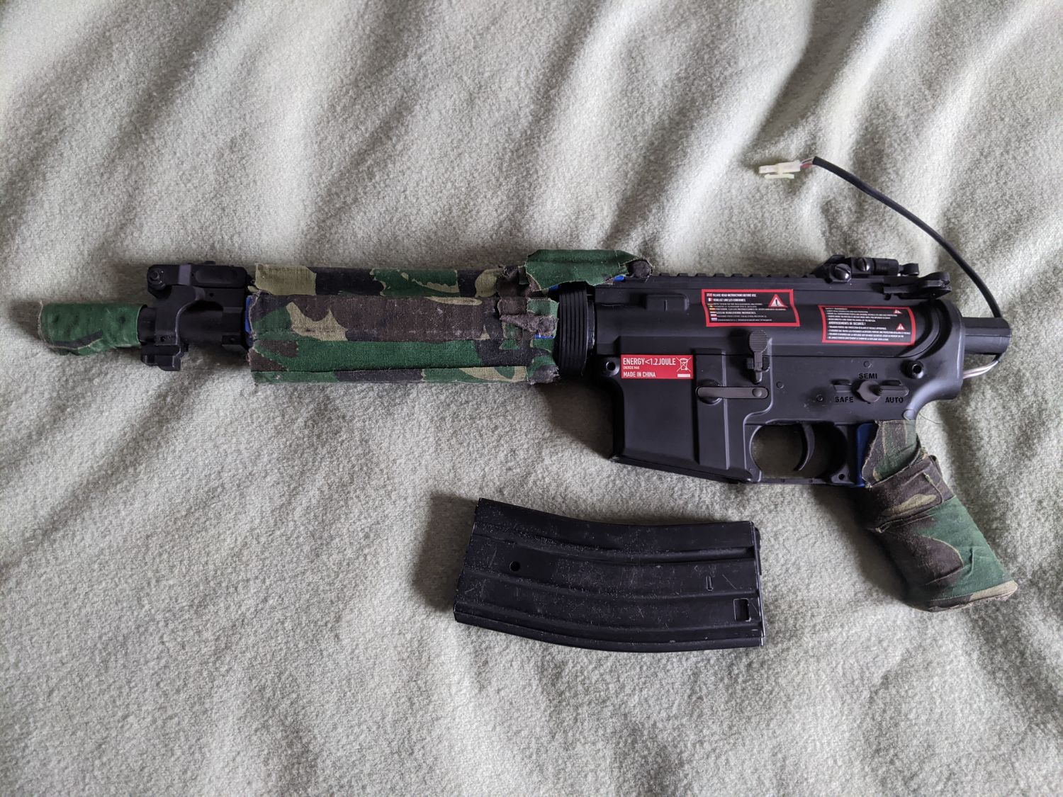

I currently have a nuprol pioneer defender, and I've lost the stock.
What I'm left with is in the pic.
I ran it at the last skirmish I was at - even got a few kills.
I taped a lipo to the side and sallied forth.
The only problem I had was the bugger would barely shoot on single shot - which I only found out when I really needed single shot!
What might the culprit be and how could I fix it?
