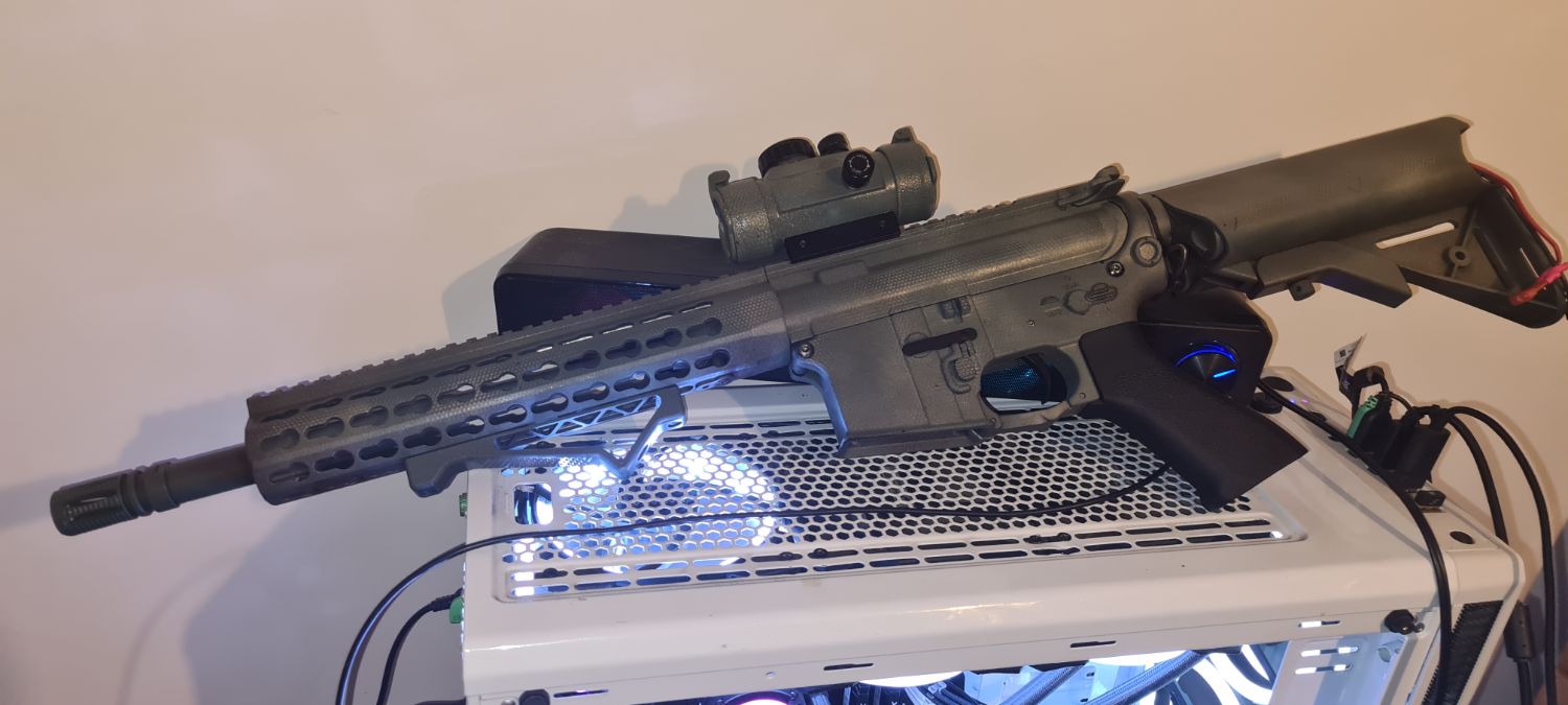

Misery Posted February 22, 2021 Author Posted February 22, 2021 well she is finaly finished seems to be running sweet dry firing anyway just bout to test it with some rounds she has also cost me my 2ndry screen on my pc well more myself has put the spring in the wrong way it bound got it apart but as i did it shot through grip and hit my 2nd screen lol thank god wasnt my gaming scree lol
Misery Posted February 23, 2021 Author Posted February 23, 2021 the 621 saga continuesok so testing today has shown that the safety latch is pretty much screwed cant use safety at all regardless of what trigger,also in semi it will shoot a few semi shots then ahoot again and get a burst that continues for a second after i have removed my finger if switch to full auto it does auto but continues for a second or so after removing finger from trigger i did upgrade the tappet spring to a gaurder one but doubt thats causing the issue @Sitting Duck what you reckon sorry to be a pest again bud
