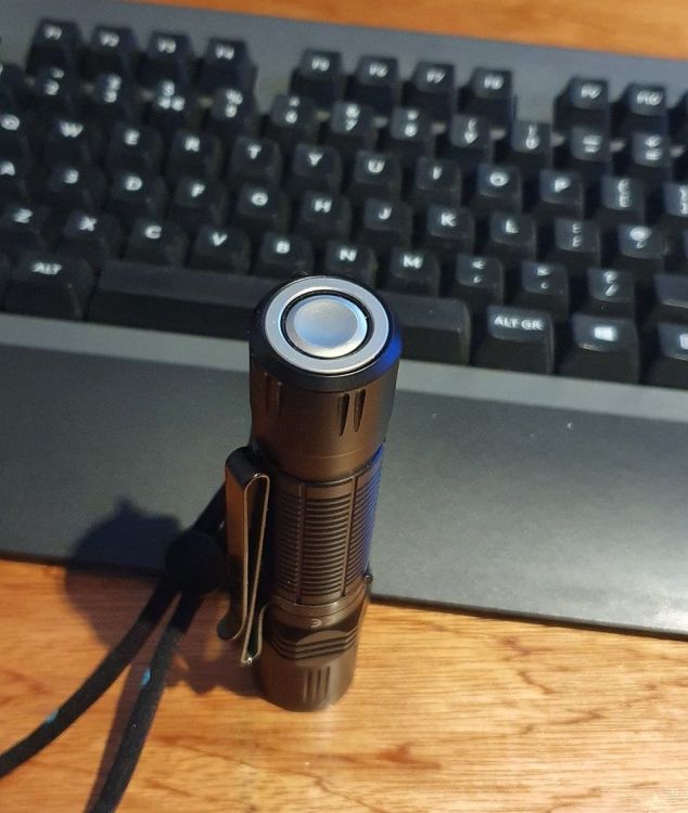

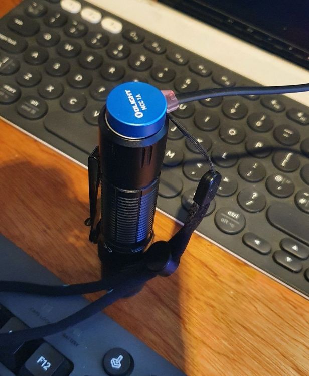

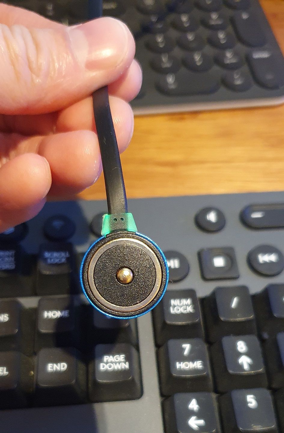

Supporters Shizbazki Posted January 15, 2021 Supporters Posted January 15, 2021 Hi all so I just briefly read the reddit page and most replies to the Threads. I own several OLight torches which are as follows: Olight Perun 2 3 x Warrior M2R OPEN i5T EOS All except the OPEN and i5T EOS use the 18650 battery which are 3.7v Lithium Ion batteries. I carry a Warrior M2R on my Police duty belt for work and have found it to be very good and very bright. For those of you that don't know OLights have an in torch charging feature where there is a metal magnetic pad on the back of the torch that snaps to a charging cable. That charging pad also acts as an on/off switch. Having seen the fact that the man had the OLight Torch in his mouth and can definitely state with certainty that saliva DOES cause a short circuit with the torch. Having placed this torch in my mouth whilst at work I noted a very strong stinging sensation on my tongue as the saliva and tongue were bridging the magnetic pad on the back of the torch. How much current goes through i don't know but it does feel stronger than a 9v battery if only because these 18650 batteries most likely have a higher "C" rating. It is quite possible that the bridging of the gaps via saliva and tongue for long enough led to a short circuit and we all know what happens when a lithium battery short circuits. And in this case its a battery in cased in a short aluminium tube so when it pops, it POPS! Just to help clarify with pics: Above is the OLight torch charger supplied with most torches from OLight, its plugged into USB with a centre dimple and outer ring, you can see where the cable goes in that it is Green. It is only green when it is not charging or the torch is fully charged. Above is the charger attached to the torch and charging it, the part that was green is now red to indicate that it is charging. Lastly, above is where the torch is charged from. The centre disc and ring are essentially the contact points for the positive and negative terminals of the battery. Shorting the two does cause a short circuit and sticking your tongue between them, you do notice it.
Supporters Shizbazki Posted January 15, 2021 Supporters Posted January 15, 2021 So the moral of this! If you own an OLight, don't stick it in your mouth or pretend to be giving a blowie ?
rj1986 Posted January 15, 2021 Posted January 15, 2021 9 hours ago, Shizbazki said: So the moral of this! If you own an OLight, don't stick it in your mouth or pretend to be giving a blowie ? You're not the boss of me
Supporters Adolf Hamster Posted January 15, 2021 Supporters Posted January 15, 2021 if that's the cause then surely this is a design fault? people holding torches in their mouths while working on something that requires to hands isn't exactly a new or obscure concept.
Ad_ Posted January 15, 2021 Posted January 15, 2021 10 hours ago, Shizbazki said: I carry a Warrior M2R on my Police duty belt for work and have found it to be very good and very bright. For those of you that don't know OLights have an in torch charging feature where there is a metal magnetic pad on the back of the torch that snaps to a charging cable. That charging pad also acts as an on/off switch. Having seen the fact that the man had the OLight Torch in his mouth and can definitely state with certainty that saliva DOES cause a short circuit with the torch. Having placed this torch in my mouth whilst at work I noted a very strong stinging sensation on my tongue as the saliva and tongue were bridging the magnetic pad on the back of the torch. How much current goes through i don't know but it does feel stronger than a 9v battery if only because these 18650 batteries most likely have a higher "C" rating. Looks like the Olight M2R Warrior is poorly designed in that respect at least... still, the maximum current that 18650s are rated for is typically in the 3-5A range, and I doubt it would be pushing that much current through saliva (you'd definitely feel a lot more than a mere stinging if it did). Anyway, the light the man had was an Olight T20 which does not have any kind of built-in charging functionality, the back of it has a standard forward clicky switch with a rubber boot covering it so there are no exposed contacts & it's rated waterproof to IPX-8, so it's unlikely that a short caused by saliva was a factor.
